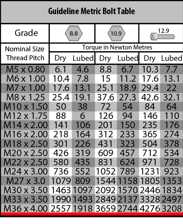

Hey, I have the p/n for the bolt that holds the fuel tank on. BTW I have a 83 kz650 csr. The bolt is a 8x30 but I was hoping to head down to the local hardware store and pick one up. Anyone know what the thread pitch is l. Or should I buy one of every 8x30 bolt they have and hope one works? Lol.

1.25 is the standard pitch for a M8 screw. I'd be surprised if that tank screw is different.
