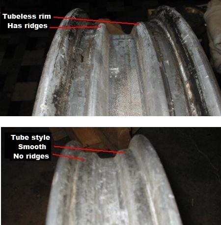

- Thanks: 2830
Re: lubricating the innertube
10 Apr 2020 20:50 - 10 Apr 2020 20:53
I noticed that the rims Jake the Garden Snake used had the extra ridge that would help keep a tire in place if air was lost or the tire was bumped sideways. Unfortunately many tube type KZ rims don't have that ridge, so there's a risk that the tire without a tube could lose all pressure under certain circumstances. Ed
