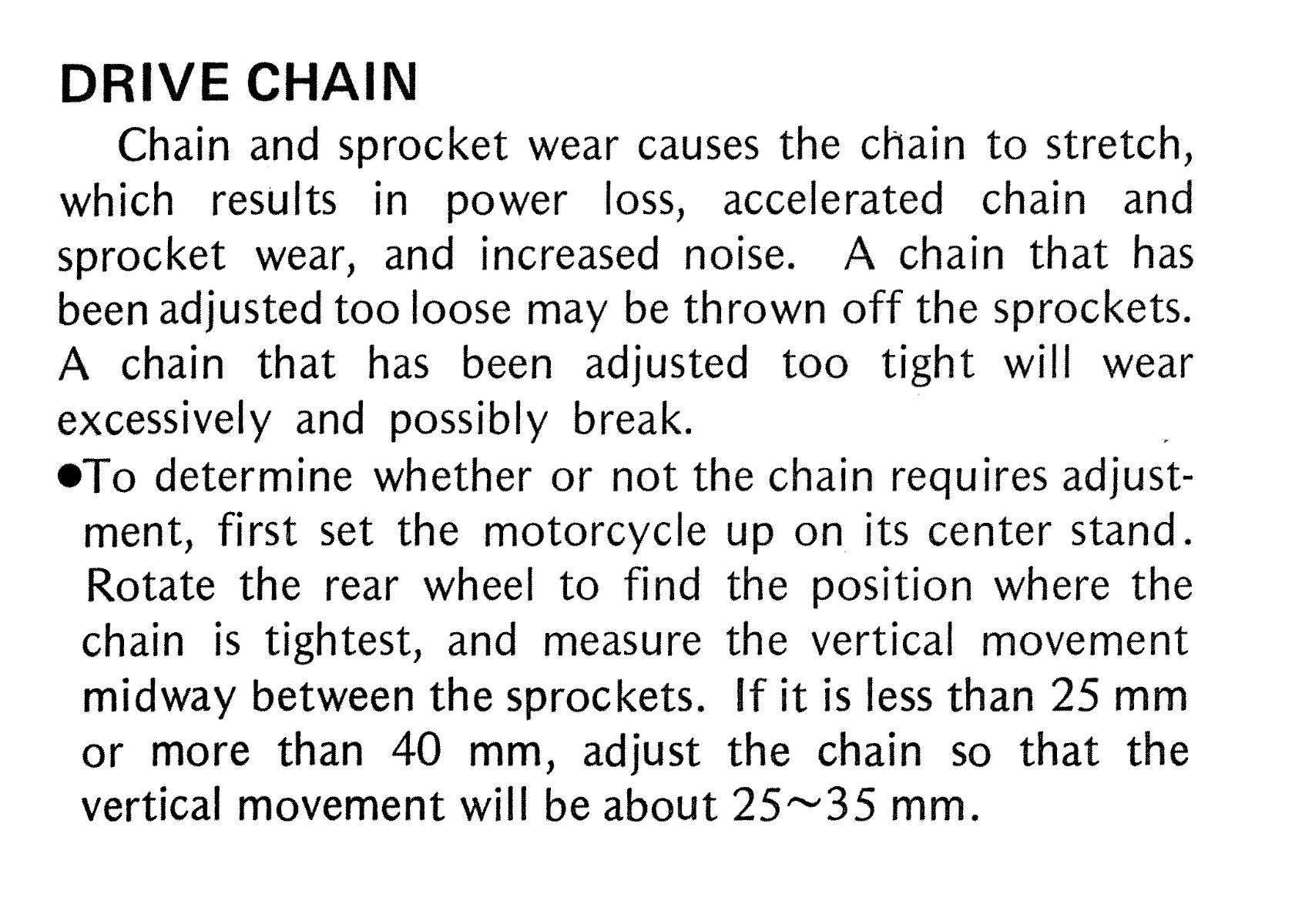

Notice the clip below from the KZ750 Twin Kawasaki Service Manual specifies 25 -35mm = 1.0 - 1.4 inches of drive chain slack. 3 - 4 inches is WAY too much slack! Ed
