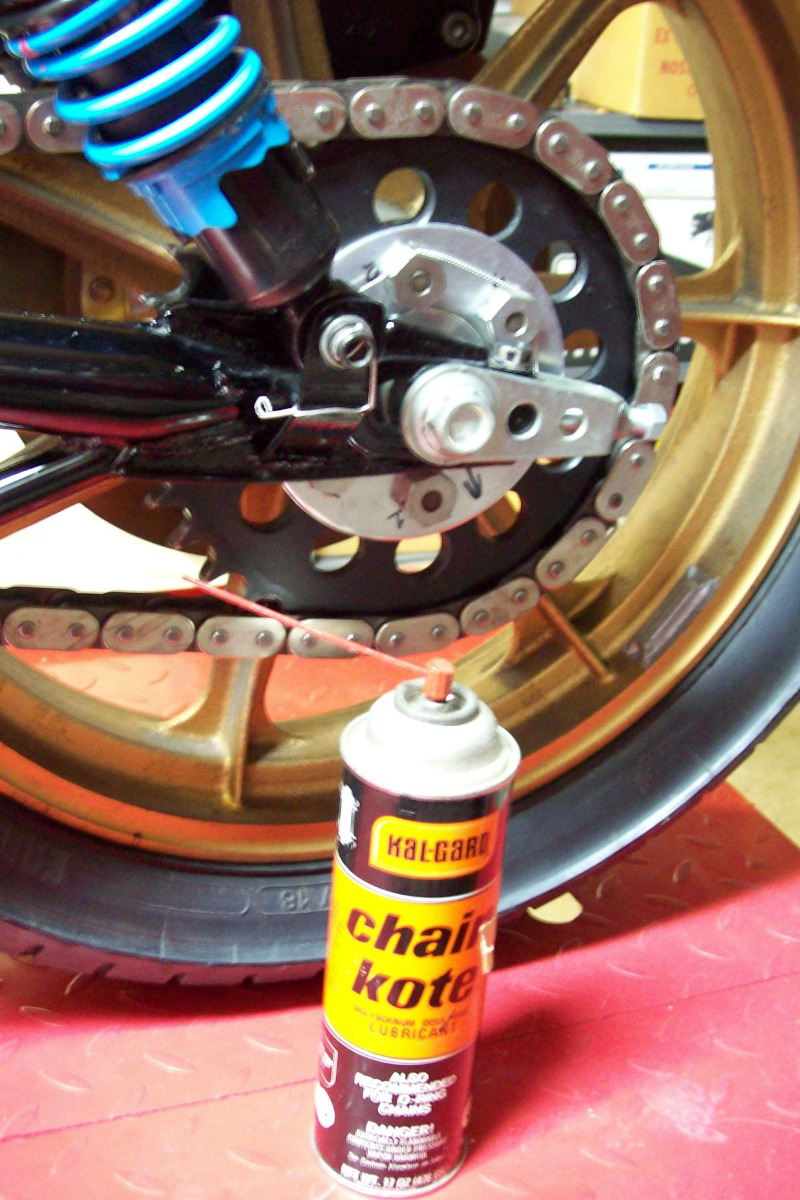

Lets talk some basic chain maintenance along with chain lubes. First thing you have to have is a properly adjusted chain. ALWAYS check your chain tension with both wheels on the ground, and you sitting on the bike. Just reach down and check the play in your chain. If you set your chain tension up on the center stand, then roll the bike off the center stand. You will see that the chain has tighten up considerably!!! On my Kz1000 if I set chain tension with the bike on the work stand, then roll it off the stand and sit on bike. My chain gets as tight as a banjo string!!!!!
Always apply your chain lube when you come back from a ride. A hot chain helps the solvents in the chain lube evaporate a lot quicker. If you spray your chain before you go out for a ride, you find out the chain lube has covered the rim and inner fender of your bike!!! Always spray your chain lube on the inside of your chain. Centrifugal force will cause the chain lube to be forced through the chain. If you spray the outside of the chain. Its just going to be thrown off the chain covering your rim and tire. As you spin the rear wheel by hand you can hear the chain get quieter as you spray on the chain lube. It don't take much lube before you will hear the chain get quiet That is all the chain lube you need on your chain.
All of my bikes have either gold or white wheels, and most don't have any type of chain guard on them. Plus most of my riding used to be done at far from legal speeds. The only chain lube that I found that flies off the least is Kal-Gard Chain Kote. Even on my little Rg500 with white wheels the Chain Kote barely leaves just a few black daps of chain lube on the white rim!!! I never found anything close in chain lubes that stays on the chain like Chain Kote!!!!!

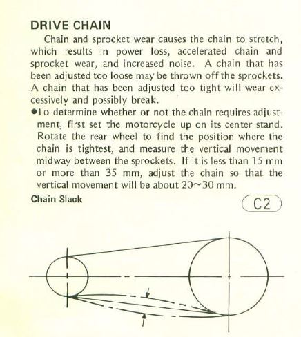

19 May 2019 13:19
