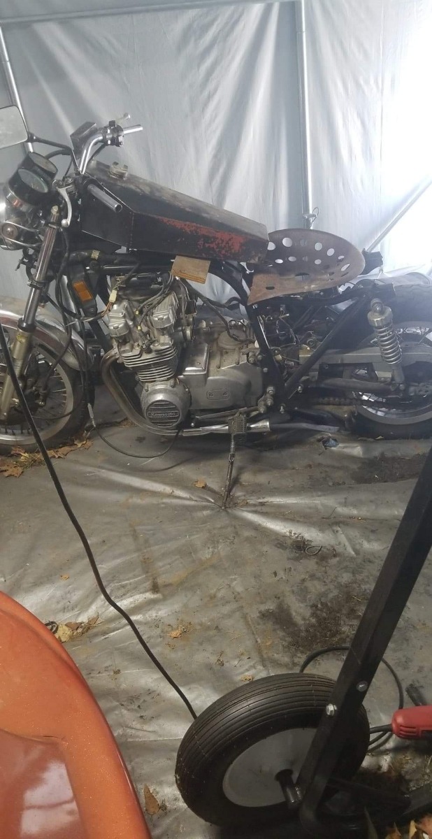

WHAT YEAR IS THAT SEAT? :lol: :lol: :lol:

Lmao, something my old man gave me, old, was on a horse drawn mower, so I would date it most likely pre 40s maybe lol
Far to wide, would of looked alright with stock tank. But not comfortable
