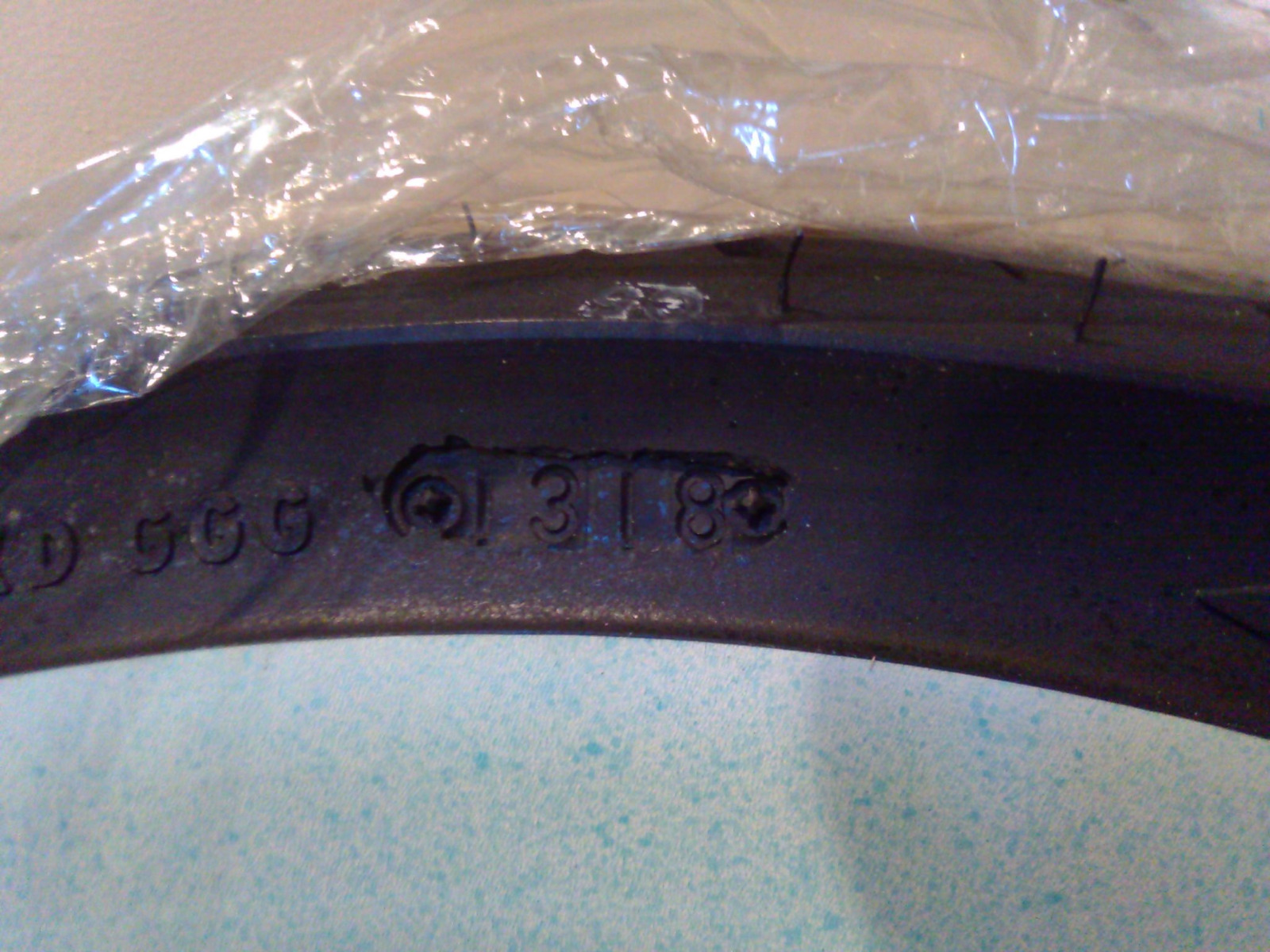

437 is (NOT) your tire date
You need to find a 4 digit number that is in an oval
The first two numbers are the week and the second two numbers are the year
I just picked up some tires for my wife's bike, this one reads 1318 which means it was manufactured in the 1st week of April 2018
I personally would not trust taking a corner fast or stopping in a hurry on tires that were more then 5 years old
The rubber gets hard and looses it's grip of the road

27 Aug 2018 07:44bluej58 wrote: 437 is (NOT) your tire date
Yea that's the code for tires from 2000 thru now... the old codes were 3 digit. .. tire codes

Yea, the 3 digit code was long ago before we knew old tires were dangerous, and most just rode til they were worn without worry or problem. The Goodyear Eagles were long ago though. I would guess 80s on the date. As said, time to go.
