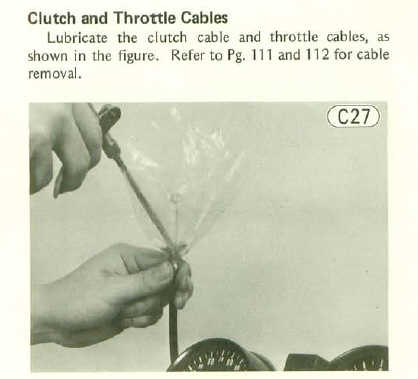

The baggie w/motor oil works just fine. I've got a Motion Pro luber but the baggie works as well or better.

The baggie and oil trick is old skool. Used it like 30 years ago. You have to wait day(s) for the oil to seep through the cable from one end to the other using gravity and capillary action for it to work. Oil leaks past the baggie, coating the outside of the cable's sheath, creating a mess.
A modern cable luber is much better. Less mess, with lube designed for the specific application. Lube is forced through the cable by the aerosol can's pressure in literally minutes, and you're ready to reassemble and ride. Unlike the baggie and oil method, that is like watching paint dry.

I'm sure the cable luber works fine and may have advantages over the bag method, but I've never had a problem using the bag method. Of course I've only been using the old skool bag method for lubing motorcycle cables for 53 years, so maybe I've just been lucky. Ed

Oil will work it's way down the cable using the baggie method in about 5-10 mins. Use a rubber band around the cable/baggie and you won't get leakage.

I use the baggie and haven't found it problematic. I'm done about 10 minutes and it's not messy if you're careful. I don't use a rubber band, I use electrical tape to seal the baggie to the cable.
