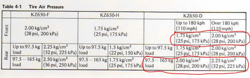

I have 1981 KZ650-D4, with 1981 z750L engine. with new tires. I have found a table in the service manual, please see attached table.
My weight is around 115 kg = 253.5 pounds.
What will the optimal pressure be then ?
Rear = 29 psi ?
Front = 26 psi ?
Rear = 29 psi ?
Front = 26 psi ?

Accordign to the tire pressure table I`m thinking:
Front: 28 PSI = 1.9 bar
Rear: 32 PSI = 2.2 bar
Can these be a good start point....
I have found on other forum for Pirelli MT66's the recommendation is:
front= 32-42
rear= 36-42
But these is higher than Kawa. recommend in the service manual?
Shall I start with front 32
and rear 36 then ?
I mean the pressure as physics force has been the same as long as we human has lived on the earth, and I assume the Kawa has sent up these numbers
based on weight + suspension + etc etc... ?
So why have higher pressure in 2018 then in 1981, is the reason because the old tire doesn't handled higher pressure?
