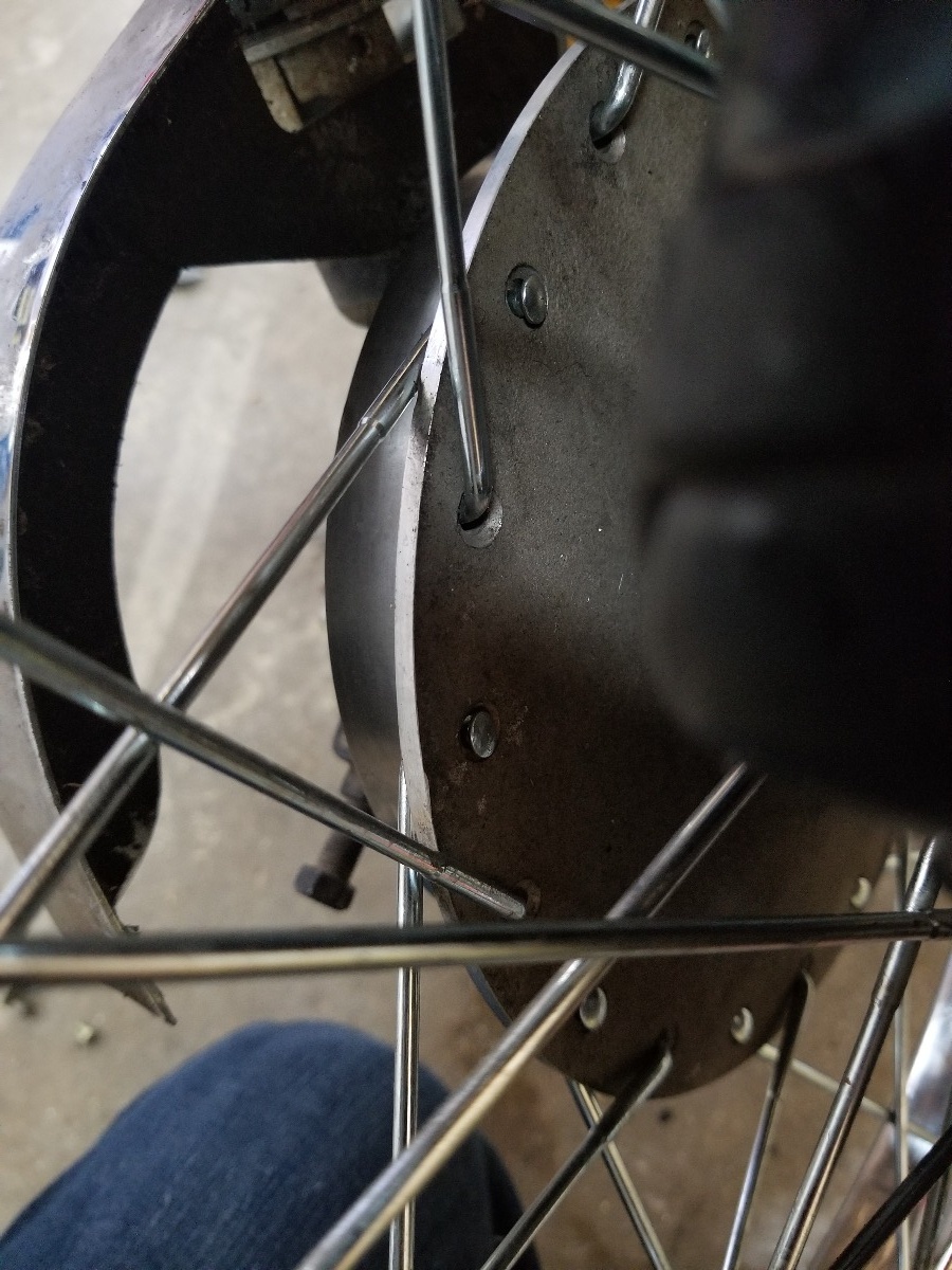

Just got done lacing and truing my rear wheel with new emgo replacement spokes I noticed that the spokes in the hub seen to not sit as nice as I would like is this normal the wheel seems fine just not as good of fit as oem

This is a kz750B /kz1000A rear wheel I did not take a pic before I simply removed the old spokes one at a time and replaced them with new it is laced correctly I think I just have cheap spokes like I said emgo brand

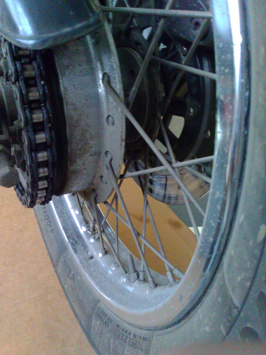

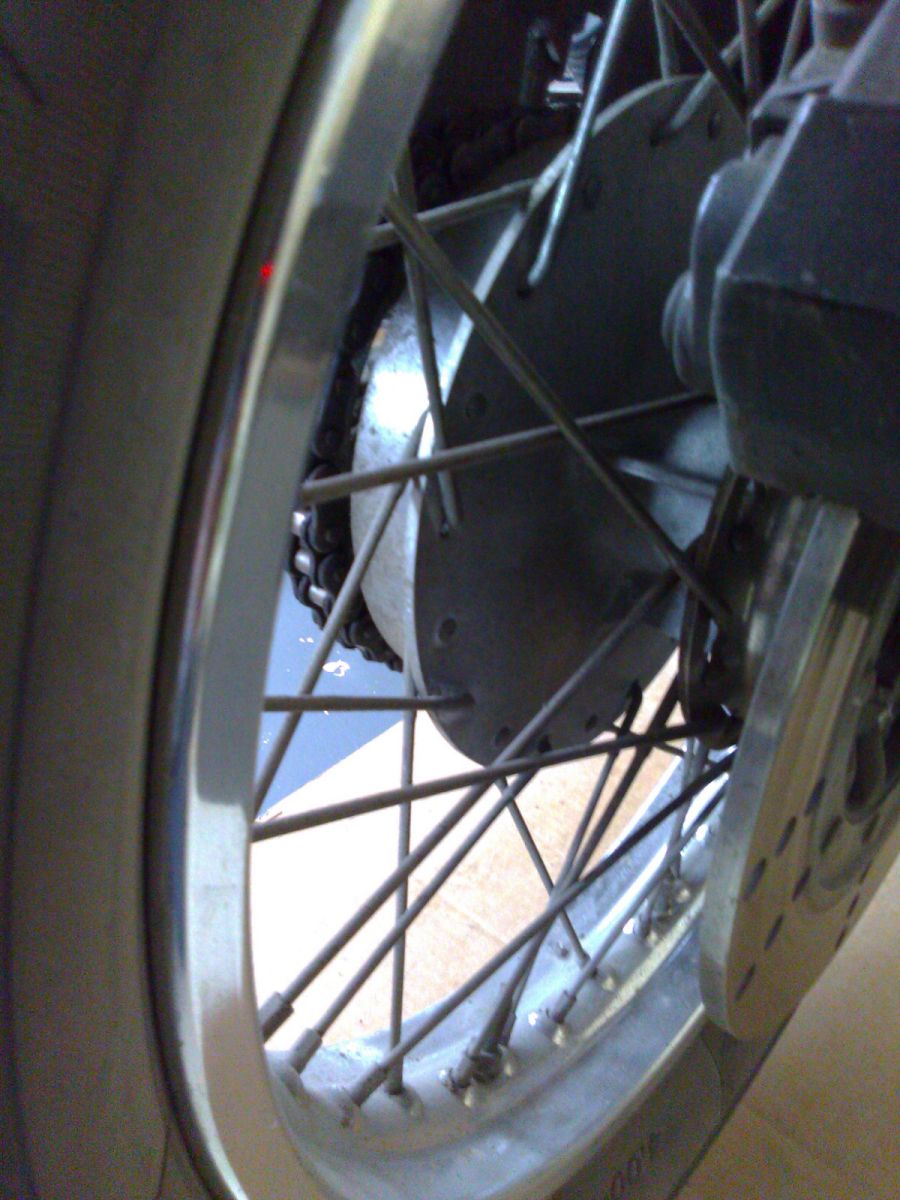

- bluej58
- Posts: 2474
- Thanks: 507
- kz650guy

Thanks for the wheel pic so I was curious and took one of the new spokes out and put an old one back in they are very slightly different the old spoke sits in nicley I'll take pic of the difference

I've not built a motorcycle wheel before but have done lots of bicycle wheels and with those you need to bend over the spokes in order to seat them in the hub. The new spokes don't seem to be seating fully in the hub and they could add stress to both the hub and spokes. If it was a bicycle I'd tell you to bend the spokes to assure they seat fully but I'm not sure if that same advise is appropriate for a motorcycle wheel.

I bent one to see I did get a much better fit I just feel like I should not have to but for a set of new emgo spokes for 35 dollars I should have known the quality was probably not as good
