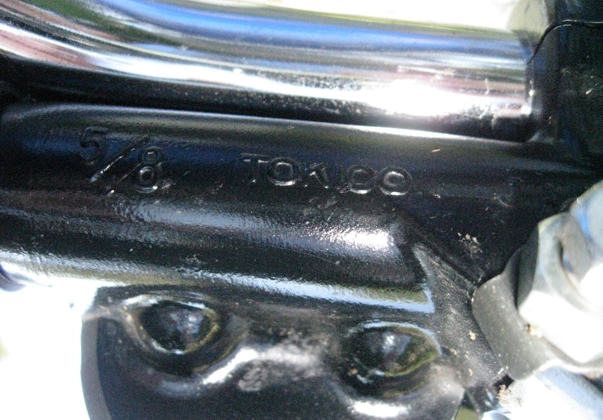

I'm pretty sure most dual disk KZs are 5/8. Partzilla & eebbaayy photos can be handy for stuff like this. I looked up the stock master cylinder & checked the cross-reference at partzilla. Then searched the relevant info on eb. The mc photos I saw on eb have 5/8 on the underside.
5/8 = 16mm. 14mm may be suitable as well, but 16mm is closer to 5/8".

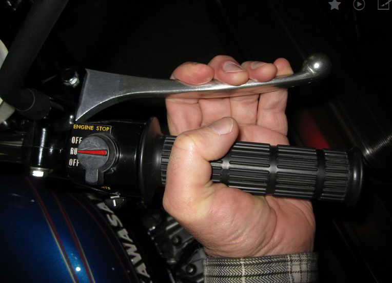

martin_csr is correct; the master cylinder bore size for the dual front disk bikes is 5/8" (see 1st pic below). You may have air trapped in the brake line. I recommend you change the brake fluid and be sure to bleed the brakes so there is no air in the lines. The 2nd pic below shows my KZ650-C1 brake lever pulled in as far as it will travel - the brakes work very well. The entire brake system on my bike is stock. Ed
