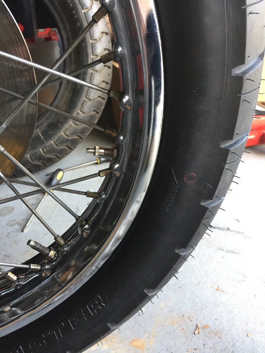

Do Shinko tires have the yellow dot? or some other mark that you're supposed to line up with the valve stem?

Two comments -
- I ALWAYS install the rim locks even though I'm running fresh Pirelli tires. He must be nuts to just cover the holes with duct tape. Having been on a bike when the rim slipped inside the tire, ripped off the valve stem, and caused an immediate blowout at 45mph in heavy traffic I highly recommend you do use the rim locks.
- 2 ounces of weight to balance is pretty much at the outside limit. Did the guy align the dot on the tire (I'm assuming Shinkos are marked like many other tire brands) with the valve stem? If not, that may account for the 2 ounces of weight needed.

09 Mar 2017 14:16 - 09 Mar 2017 14:19

That looks correct. Ed
