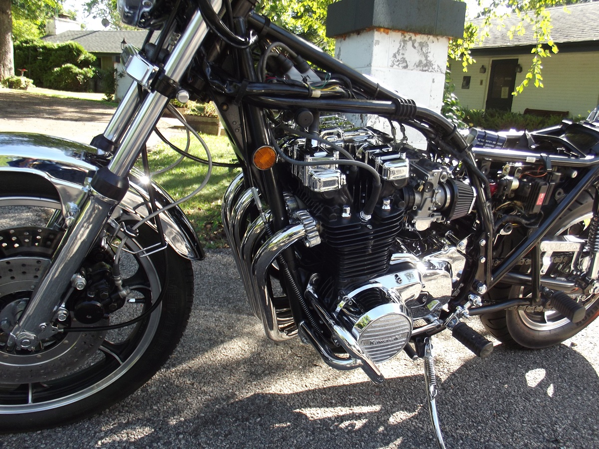

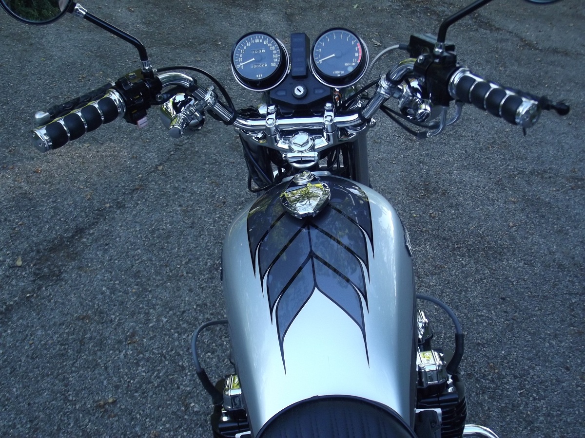

- pete greek1
- Posts: 1510
- Thanks: 185
Re: Motion pro custom clutch cables
17 Aug 2015 10:39
- pete greek1
- Posts: 1510
- Thanks: 185
17 Aug 2015 10:46
- GPz550D1
- Posts: 254
- Thanks: 22
17 Aug 2015 11:32Wow, that engine is beautiful!
1981 KZ550-D1
- pete greek1
- Posts: 1510
- Thanks: 185
17 Aug 2015 13:27I think I spend more time cleaning & polishing, then I do riding, :silly:
