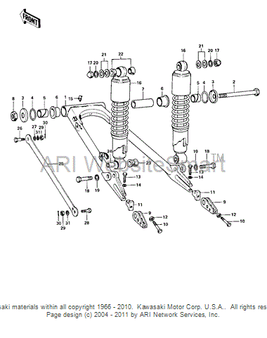

Thanks for posting the schematic MotorHead, 650ed, it's for my KZ900.

Below is a diagram of the 1976 KZ900 swingarm that shows part numbers and names. It uses bushings rather than bearings. If you plan to convert it to bearings you may want to double check with Z1E to make sure the bearing kit has everything you’ll need for the conversion and that it will fit in your specific model. You won’t need the bushings and sleeves shown in the diagram if you are going to convert it to bearings; it will use bearings or bushings, but not both. Personally, I’m not sure if bearings offer a real performance advantage over bushings, although I’m sure someone will chime to describe the advantages. IMHO Both work very well. Ed
