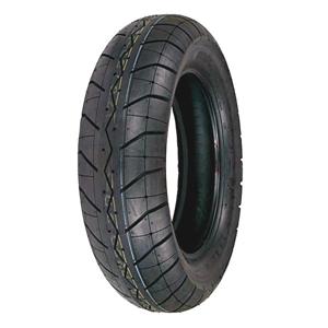

I had another tire from Shinko and got a bit over 4500mi on it. the last trip used up the center, so I was going to try this one which is more for the type of riding I do. Hoping to get more life out of the tire at the weight loads and speeds with still decent cornering. The reviews look good, except for a wet handling complaint. harder tires are going to be like that.
Well I went ahead and ordered this tire while it was on sale. I would still like any feed back about it or the brand. After I get it and do the install I'll post some comments.

Well after a few rides around to knock the New off of the tire, I measured the tread depth at 8.4mm in the groove in the middle, that's where it will wear the most. Feels real good, more stable in the curves. Just a different tread and compound than the last 720 Shinko i ran.

OK so I have around 4K miles on this Shinko Tour Master now. I'll review it a bit.
First as I had read in the customer reviews before purchase, the wear in the center is as expected, still got 3.76mm of depth. Was 8.4mm new. So definitely more than 2/3's worn.
The problem I found with it is that the right side of the tire has handling issues. When new and inflated, you could see the profile was taller on the right compared to the left, very strange indeed. Now it is even showing some cupping on the right side of the tread pattern. this has from new caused a wobble when cornering to the right then going through a dip or bump. It was a bit unnerving a few times, and some may find that their shorts would stain. :sick:
I won't get this tire again due to that issue, and once I reorder another tire it will be coming off and then trashed. I had almost got a Dunlap 404 from a local on Cl. I think I'll get that next time.
