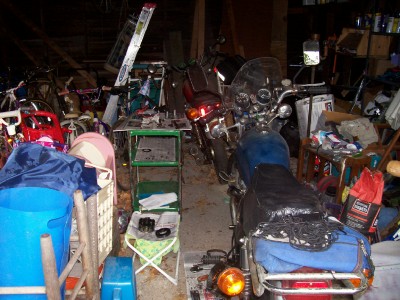

So I took it the dynamo/starter clutch covers off. Do you like my pretty garden stool? I wanted a manly red and black Craftsman wheeled stool, but this was a lot cheaper.

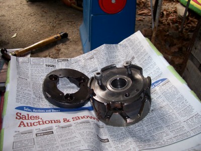

In my starter clutch, I found metal shavings, ick. When I finally got it off (with hammers and screwdrivers, etc), I found out why.
It's a little hard to see, but one of the bolts got loose, and stuck between the starter clutch and gear, where it seemed to melt when I tried to start it. Dang, it was a mess.
I had to file the edges down, cut a slot with a rotary tool and slowly get it back into the hole ( I should buy a new one, but I don't want to wait a week or two for it to arrive). It turns over now, I just need to get it going again and start my riding season.
