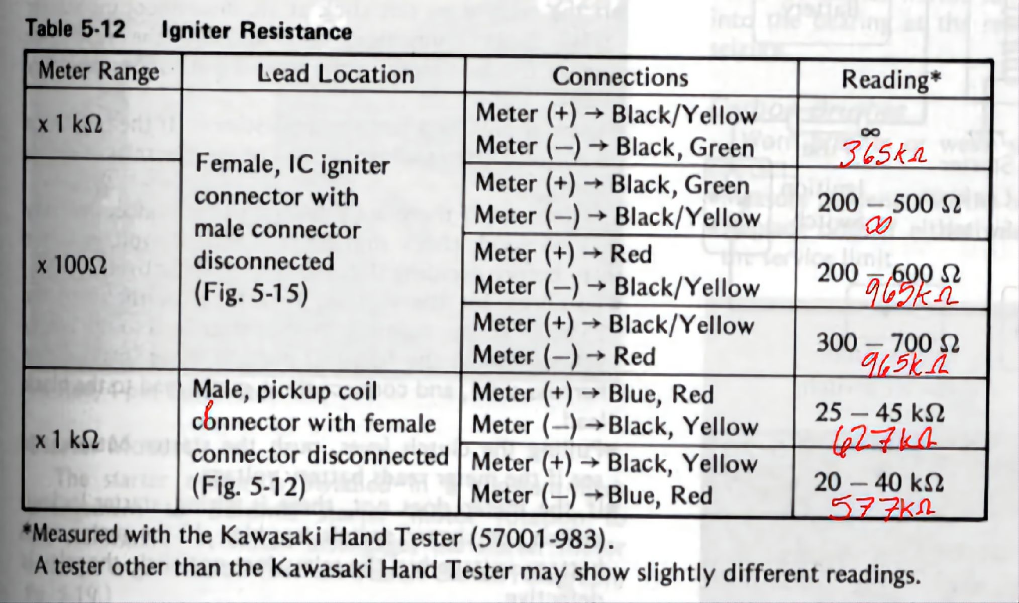

So i followed this diagram and its been a bit but I know both sides on the pickup coil side of the igniter were at about 1 megaohm. For the connection at the black/yellow and red i believe were also out of spec but i dont remember what at. Do I need a new igniter? I dont think that the igniter would cause my popping or tach problems, would it?

30 Sep 2026 07:52I would question your readings and test process - the spec for the pick ups is 20,000ohms - 40,000 ohms (20 - 40 Kohms) if your reading of 1 million ohms (1 Mohm) was correct it wouldn't run at all !!!! I suspect what you are measuring is outside the scope of your meterSo i followed this diagram and its been a bit but I know both sides on the pickup coil side of the igniter were at about 1 megaohm. For the connection at the black/yellow and red i believe were also out of spec but i dont remember what at. Do I need a new igniter? I dont think that the igniter would cause my popping or tach problems, would it?

That's totally possible! I put the multimeter to the kiloohm range and it was consistently reading at like 970 kohms no matter which way I measured it. I even tried multiple methods to make sure I was getting a good connection on my probe but it kept reading at 970 kohms!

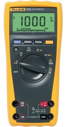

This is the multimeter im using:
Also for clarity, my test process where I got the 970 kohm reading was putting the + on the black and - on the blue. I'd get 970 kohms so I'd swap the poles and get the same reading. I would then swap over to the red and yellow wires in the same way and still get that 970 kohm reading, if i remember correctly. After that point i was trying to grab any reading that would get me close to the spec but none did. You may be right about the multimeter and I still recognize that the popping still may be from the carbs.

Nice bit of kit, looking at the spec it should be capable of what you are asking but the readings can't be right or I don't believe the bike would run at all

Yes, the igniter was completely disconnected when I did these tests. The pickup coils read fine along with the ignition coils and most of the wires on the other plug for the igniter except for the red and black/yellow but I cant quite remember what it was reading.
I do have a kz550 igniter laying around somewhere so I may be able to mess with that one this weekend and maybe try installing it and seeing what happens if it wouldnt cause any problems...

So I tested the igniter again and compared the values to the kz550 igniter. Guess what? They are almost exactly the same! This is what I got for values which is really off from spec. I don't know what to think.

I suspect your readings are off, if every circuit in the igniter was that far off it wouldn’t run
