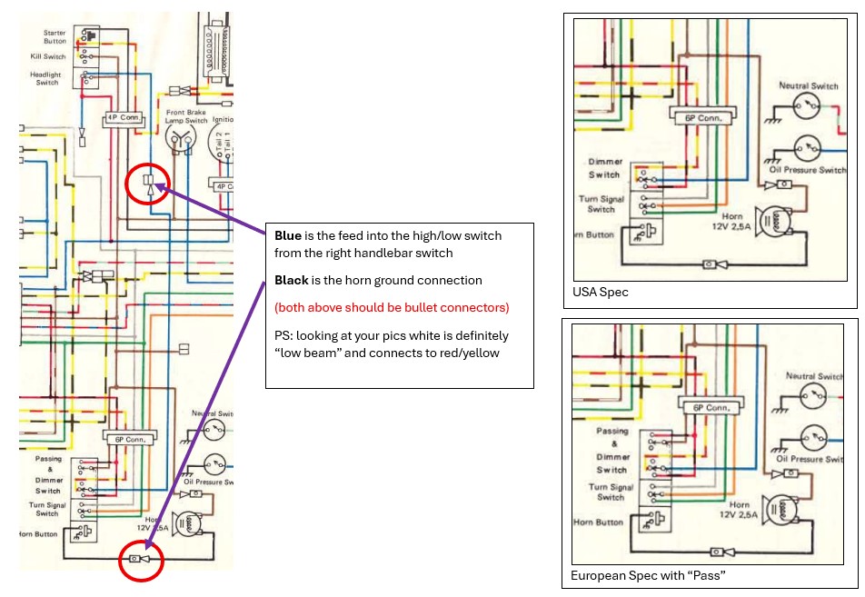

here are some photos of the left control connector. There are six wires in the connector, they all match however there are two additional wires on the switch side: black and blue. Not sure what those are for.

I know what your problem is, will get back to you tomorrow (it’s after midnight here in the UK
- Posts: 6431
- Thanks: 4070
Re: No power to headlight
30 Jul 2025 05:33I know what your problem is, will get back to you tomorrow (it’s after midnight here in the UK

🙏 THANK YOU!!! 🙏 you nailed it Wookie!! That was the solution. It’s working as expected now.
