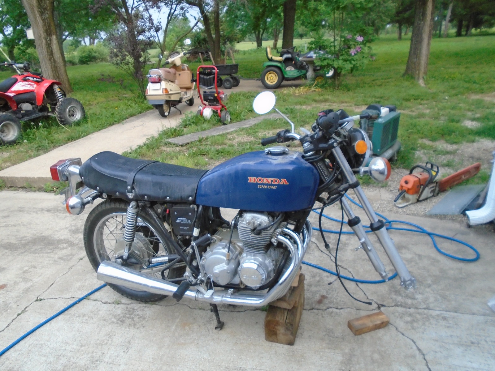

My 1975 CB400F. Beautiful bike. Is currently dead as a doornail. It ran one minute and was 100% dead the next. No light, no spark, no nothing. Changed to known good battery. Dead. Changed all fuses. Dead. Jiggled all the grounds and etc still dead. It will spin over if I jump the solinoide.
Anyone have any ideas? Wiring schematic posted here.
Where do I check this with my meter?
Any help appreciated. Very frustrating.

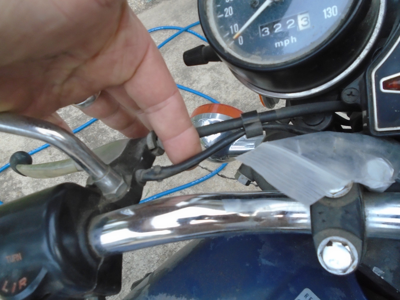

What are the odds, ha. Check you're ignition switch as mentioned, they fail but the switch can be replaced without changing the key tumbler. Also your clutch lock-out switch. Then..notorious crappy designed (Start-Headlight Out) switch in RH switchblock lower. These seem to always fail. It combines starter function and turning headlight off during the process. Lots of times they will come out in pieces.

Same bike! Same color. You can hit that blue with the polisher and it will come alive.
