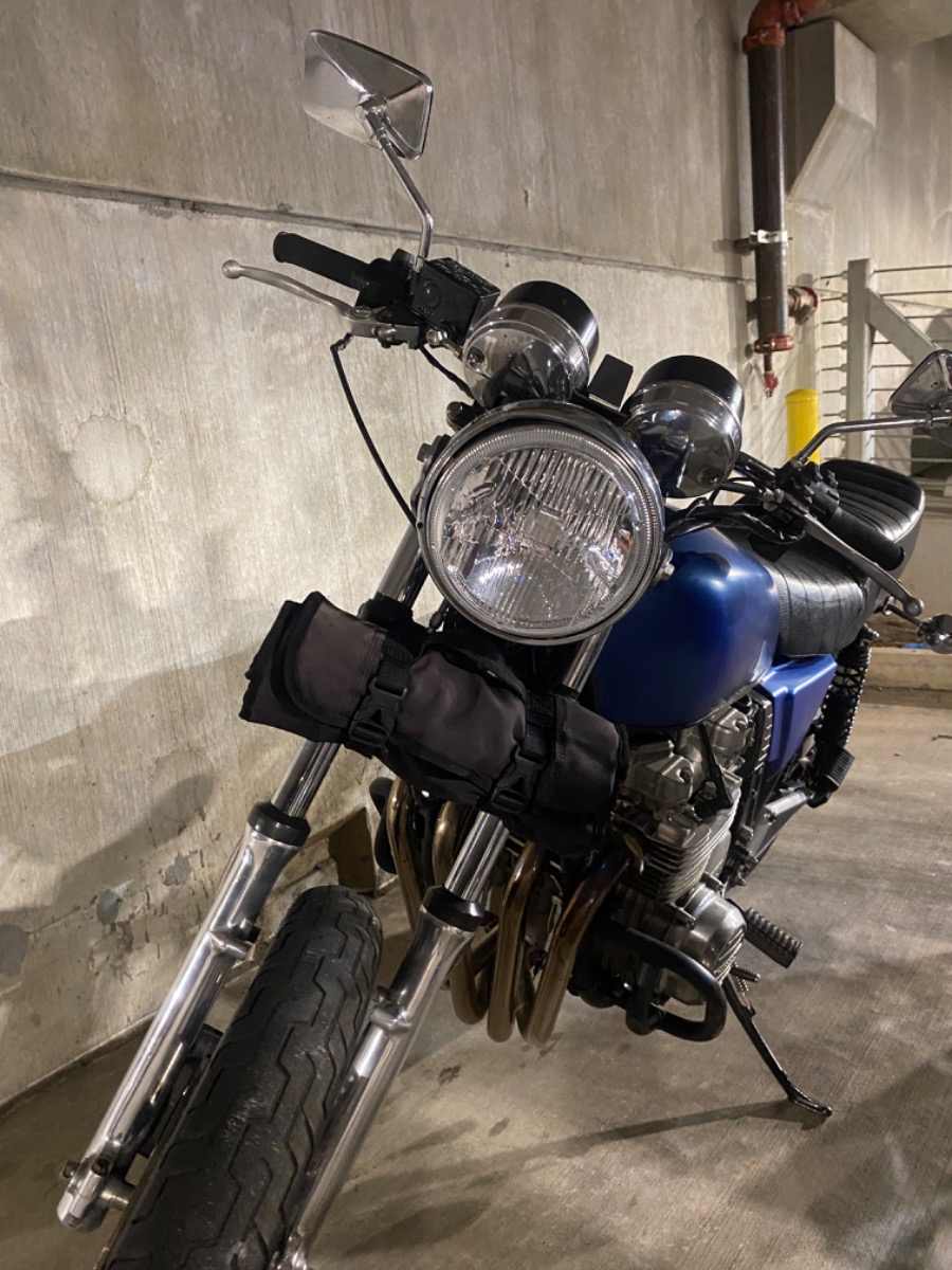

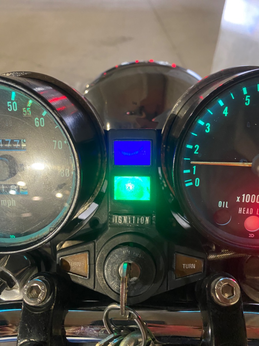

Good afternoon, I have a question about the wiring and whatnot with my 1981 KZ750(4) LTD. Today I changed the headlight to an LED one and now the high beam indicator light stays dimly lit at all times, you can definitely tell it gets brighter when the high beams are actually on but when on low beams there is a definite light coming out of it. The headlight is a Holley Retrobright 5700K H4 plug and play I bought. The Holley website has them pulling 25w on low and 30 on high. Also putting out 2000LM on low and 3000 on high.
Edit: I just looked up the halogen, it pulled 45w on low and 55 on high.
I love the new headlight and it’s actually really tasteful for an older bike not like some Amazon special got thrown in there, so I really want to make it work 100 percent.
It’s not a great picture but you can definitely see there is some light coming from behind the high beam marker. Those have also been LED swapped Im not sure if that matters or not since it worked perfectly fine when I had the Sylvania Halogen in there.

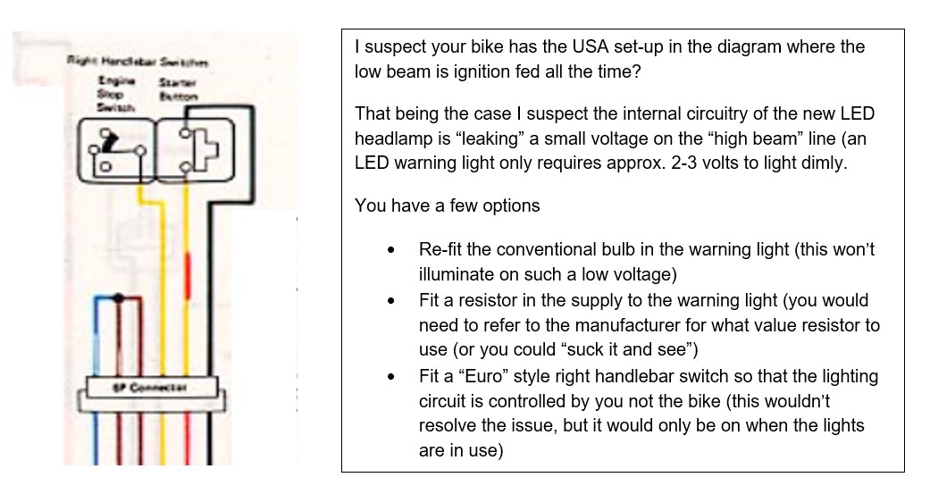

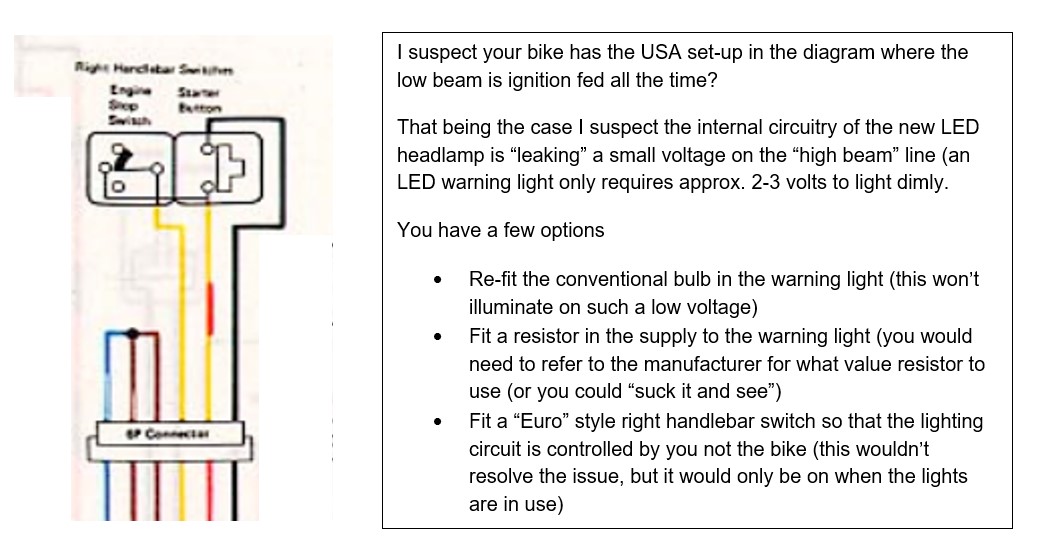

05 Sep 2023 08:33The easiest thing is to put the incandescent bulb back in the warning light (which should sort the issue) and keep the upgraded headlightLooks like returning to the halogen bulb is going to be the easiest thing to do. Definitely recommend the Holley Retrobright to anyone who is looking for a quality Led that’s plug and play with these bikes.

The 750H bikes have a "Reserve Lighting Device", which monitors the headlamp circuit and switches between high and low, if either filament burns out.
I wonder if this module isn't seeing the proper level of resistance, and now thinks that one of the filaments is burned out? You may have to add a resistor, or switch to a higher resistance bulb.

- Posts: 6308
- Thanks: 3993
Re: Kz750 LED headlight install question
24 Sep 2023 10:48I agree with Nessism, like the turn signals on most newer cars, when the circuit doesn't sense s certain amount of resistance (ex. filament bulb being burnt) then you have hyper blinkers, when using lower wattage LED,Most modern vehicles don't use "current sensing" flasher units, instead they use electronic flasher units with stand alone audible warning so you get the "click" as the flasher unit is silent (legal requirement in Europe)
there's much less pull thus telling reserve system somethings up. Happy to stand corrected but I believe the "reserve lighting" unit senses a "ground" through the lamp so that when the bulb fails the unit loses the ground on the sensor wire as a blown bulb is an "open circuit", I don't think it's resistance sensitive
