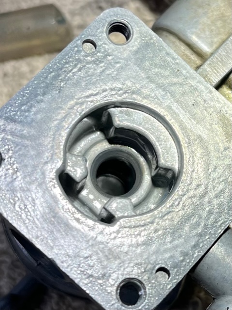

That petcock may be the problem. The vacuum line from the carb may be sucking fuel from the leaky petcock into the carb causing the mixture to be too rich to fire reliably.
When rebuilding a petcock, it is a really good idea to carefully inspect the surface that the little oring seals against. If it is badly pitted, the petcock is junk. If it is not badly pitted, it should be carefully polished to a fine finish to provide the best seal possible. I also polish the face of the lever where it seals against the large rubber seal.

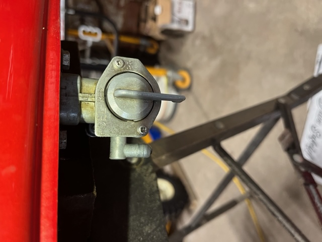

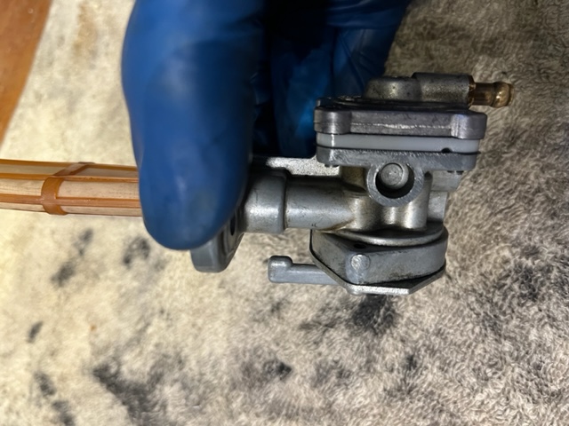

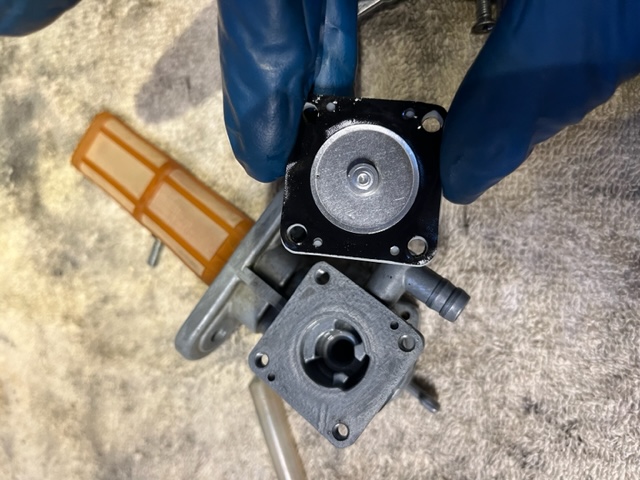

Following up on TexasKZ's reply, I noticed fuel leaking from the outlet side as well as the vacuum side (see pics). The diaphragm and plate are new... how is fuel getting over to the vacuum side? I then pulled the tank so I could remove the petcock and inspect. I When draining the tank, I switched from PR to ON, and the flow stopped. With petcock off, I pulled the drain plug, and applied suction to the vacuum port, and could see the plug move in and out. Disassembling, I noted the surface the diaphragm o-ring to be sound, and the check valve rattled around freely. Still, something's not right with the petcock, and I want to solve this issue before moving on to any possible electrical issues.

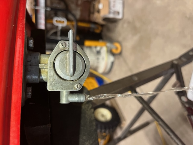

not so good news: the new cheep-o petcock is leaking on the fuel outlet... getting a little puddle of gas under the bike while it's sitting.
