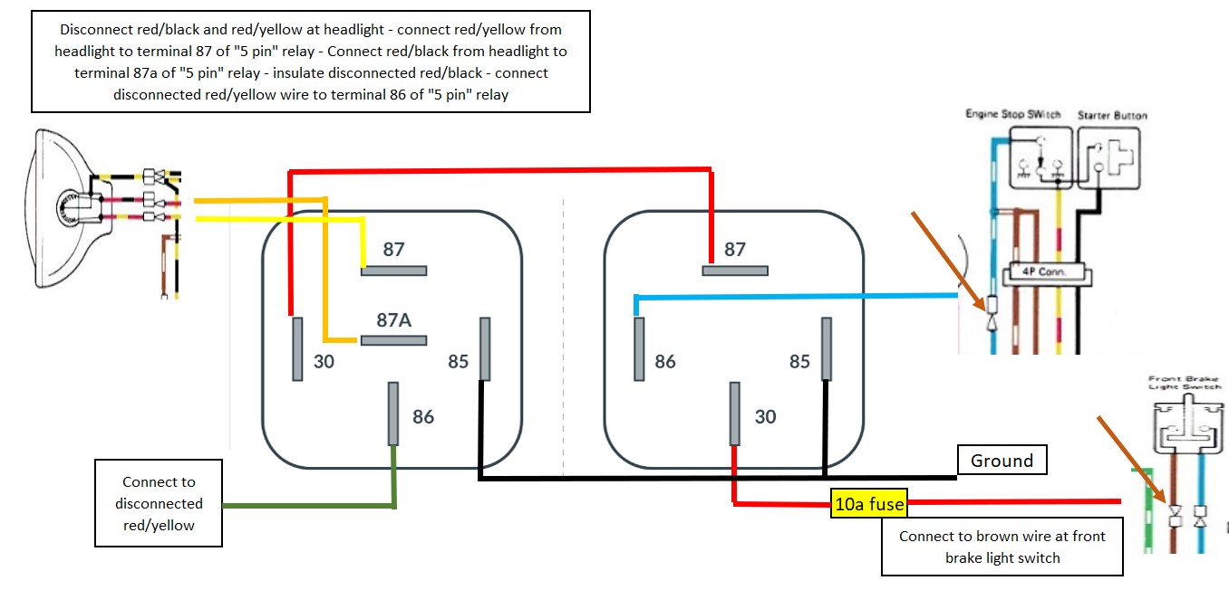

03 Sep 2023 10:24If you want to fit a brighter (higher wattage) light I can show you how to run it through a relay so you don't overload the factory electricsHi. You are correct - you need a 35/35W.

03 Sep 2023 17:33For sure, I would love to learn that. I am your student. Please advise.If you want to fit a brighter (higher wattage) light I can show you how to run it through a relay so you don't overload the factory electricsHi. You are correct - you need a 35/35W.

04 Sep 2023 03:27 - 04 Sep 2023 03:30So initially the stock headlight is fed by a 10a fuse (60w/12v = 5a) the circuit must be capable of at least 10a or the wiring would burn before the fuse blew. However if you want to take the load of of those 40 year old switches and maybe extend their life a little then below is how to take the current off of the switches. By connecting into the original bullet connectors the whole thing is easily reversible. Anything much bigger than 60w will probably start pushing the limits of your charging system.For sure, I would love to learn that. I am your student. Please advise.If you want to fit a brighter (higher wattage) light I can show you how to run it through a relay so you don't overload the factory electricsHi. You are correct - you need a 35/35W.
