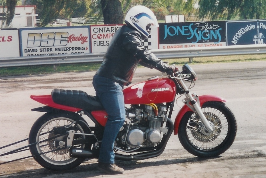

Yes, all the stator is doing is re-charging the battery so any year will work.
I use to kick start my 650 drag bike total loss - no stator, no starter, no lights, only coils, a Dyna S, and a 5ah battery.
1978 KZ650B2 modified project
