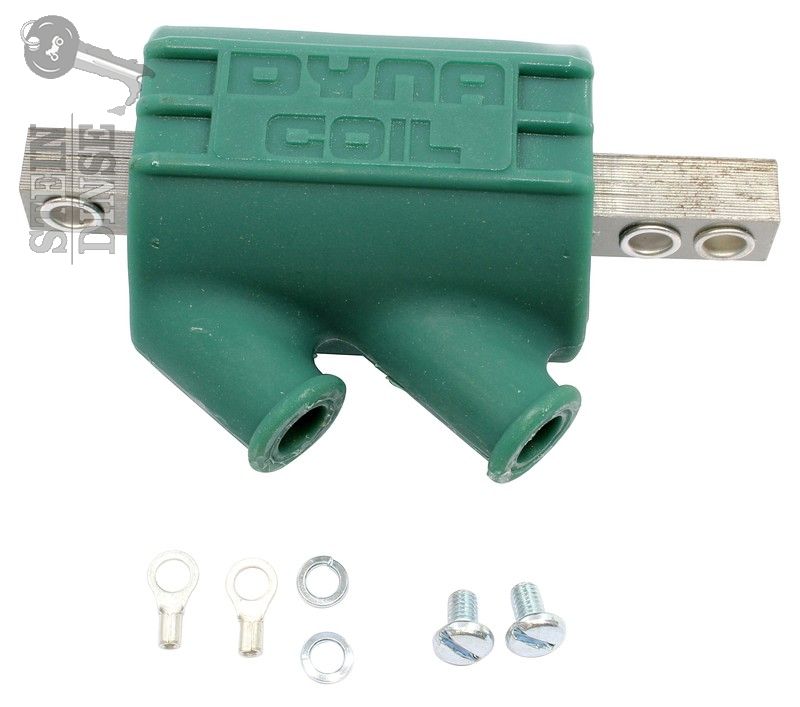

What are the best replacement ignition coils specifically for a 1980 kz750h ltd

The 750 E/H uses coils with 1.8-2.8 ohms resistance.
Dyna Green coils are 3.0 ohms
Dyna Gray coils are 2.2 ohms (a better choice)

It has been fairly common for the green coils to be used with the stock KZ electronic ignition. I installed them along with the Dyna 7mm copper core spark plug wires quite a few years ago, and went with the green in case I ever needed to go with the Dyna S ignition which specifies 3.0 ohm coils. Not that there's ever been a problem with them, but if I had to do it over again, I'd probably go with the grey 2.2 ohm coils.
