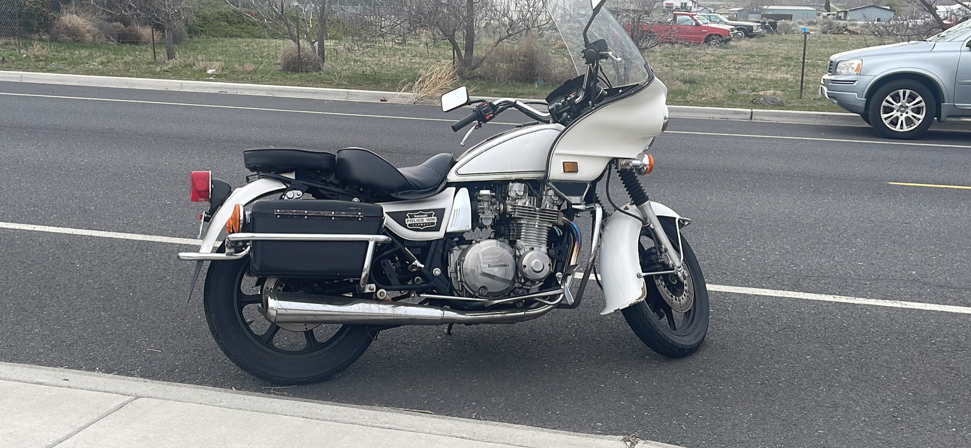

I’m just diving in to replace my regulator/rectifier. Anyone has any advice as to the proper steps for this project please let me know. Thanks in advance.

Welcome to the forum and your bike pics are always welcome too.
