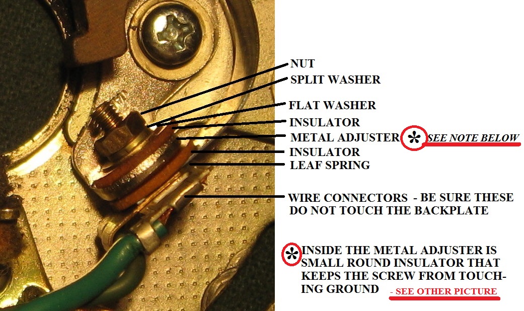

Post a pic of the ignition plate if you can.

Hello Warren, this is an image of whats on the bike at the moment.

They don't look original, there is no seperate points timing adjustment.
Probably easiest and future proof is electronic.
You can see the original ignition had seperate timing plates for each set of points.
