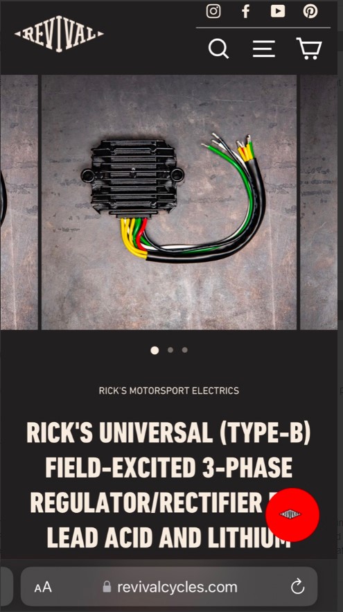

Rick's Electric sells a modern Regulator / rectifier combo

- Posts: 8205
- Thanks: 3577
Re: 1977 kz650 regulator rectifier upgrade
17 Nov 2022 08:39Rick's Electric sells a modern Regulator / rectifier combo
Gotta be careful; the Rick's R/R is a three-phase jobby, not the type for a field coil.

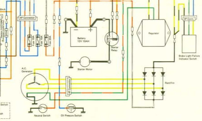

- Posts: 6878
- Thanks: 4330
17 Nov 2022 09:05 - 17 Nov 2022 09:23
I believe this is the boy ? Although the 650 has a field coil style charging system it is still 3 phase
Last edit: 17 Nov 2022 09:23 by Wookie58.
The following user(s) said Thank You: Nessism, riturbo
- Posts: 8205
- Thanks: 3577
17 Nov 2022 13:06
Humm, Type-B... That doesn't come up when searching on their site for '77 KZ650. It's good that they have one, though.
