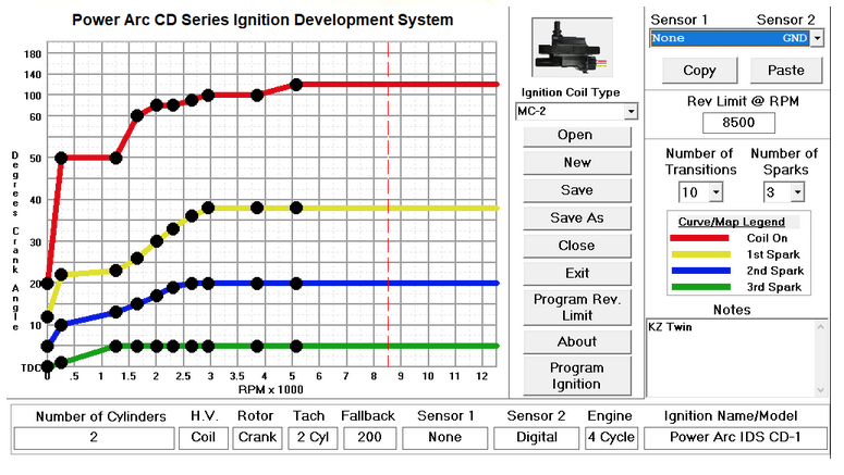

It is possible that the incorrect timing curve is loaded on your ignition. Total advance should be happening at 3000RPM. Here is the ignition curve that Powerarc created for the KZ twins, taken from their software. You can connect the ignition to a windows based computer to access the timing maps and use the Powerarc software. Its also possible to connect the extra wire to trigger a second map.
what spark plugs are you running? Power arc requires the use of resistor spark plugs. Could be a fuel mixture issue as demonstrated by increased popping on decel.

06 Oct 2024 08:48I did tests with the ignition gun, which although not suitable for this type of ignition, gave conclusive results:It is possible that the incorrect timing curve is loaded on your ignition. Total advance should be happening at 3000RPM. Here is the ignition curve that Powerarc created for the KZ twins, taken from their software. You can connect the ignition to a windows based computer to access the timing maps and use the Powerarc software. Its also possible to connect the extra wire to trigger a second map.
The ignition advances progressively from the F mark to the two-line mark of the total advance through the first 3,000 rpm.
After that, it remains steady until about 5,700 rpm, when it begins to oscillate between the two lines and the F mark.
Finally (6,000 rpm onwards) the ignition moves back to a point between the F and T marks (closer to T) and continues in that position for the rest of the rpm range.
All tests gave the same results. I deduce from this that the device is not broken, it sounds more like an incorrect ignition mapping.
What do you think?
