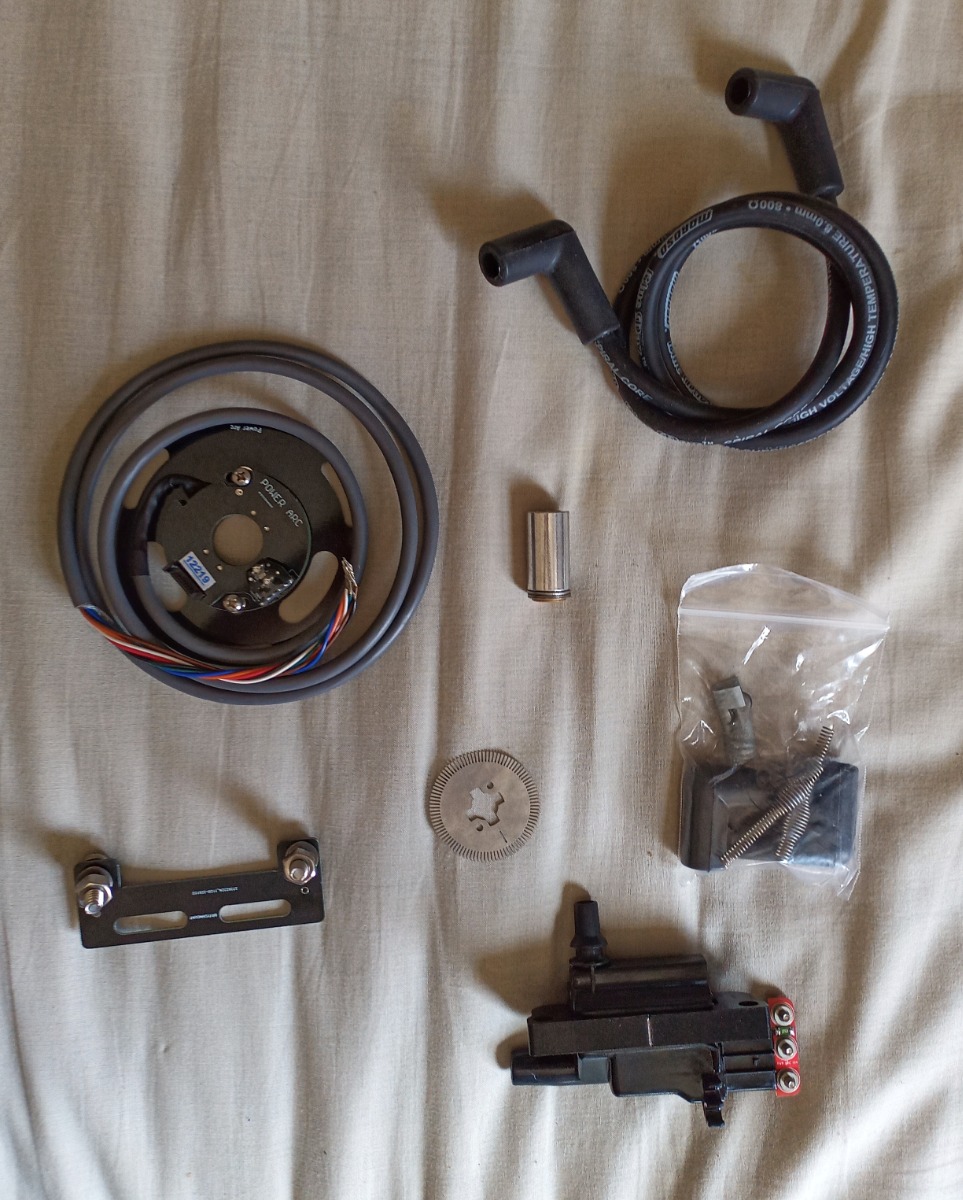

The package has finally arrived. This is the content I received:
It seems that everything necessary is there, but no assembly instructions are included, nor any reference to obtain them.
With a little research I discovered that Power Arc does provide assembly instructions on their website. It also appears that 7thgeardesigns is simply a reseller of Power Arc, with apparently no modifications to the product at all.
Maybe he has programmed the specific power curve for the KZ400 into the chip? I'll ask Power Arc to see if I can find out anything, since this man Jim decided to stop answering my emails over a year ago.
Thanks to all those who have helped me with this, especially riturbo. I will post in this thread everything I find out about this ignition and its assembly and experience of use, for anyone who may find it useful.

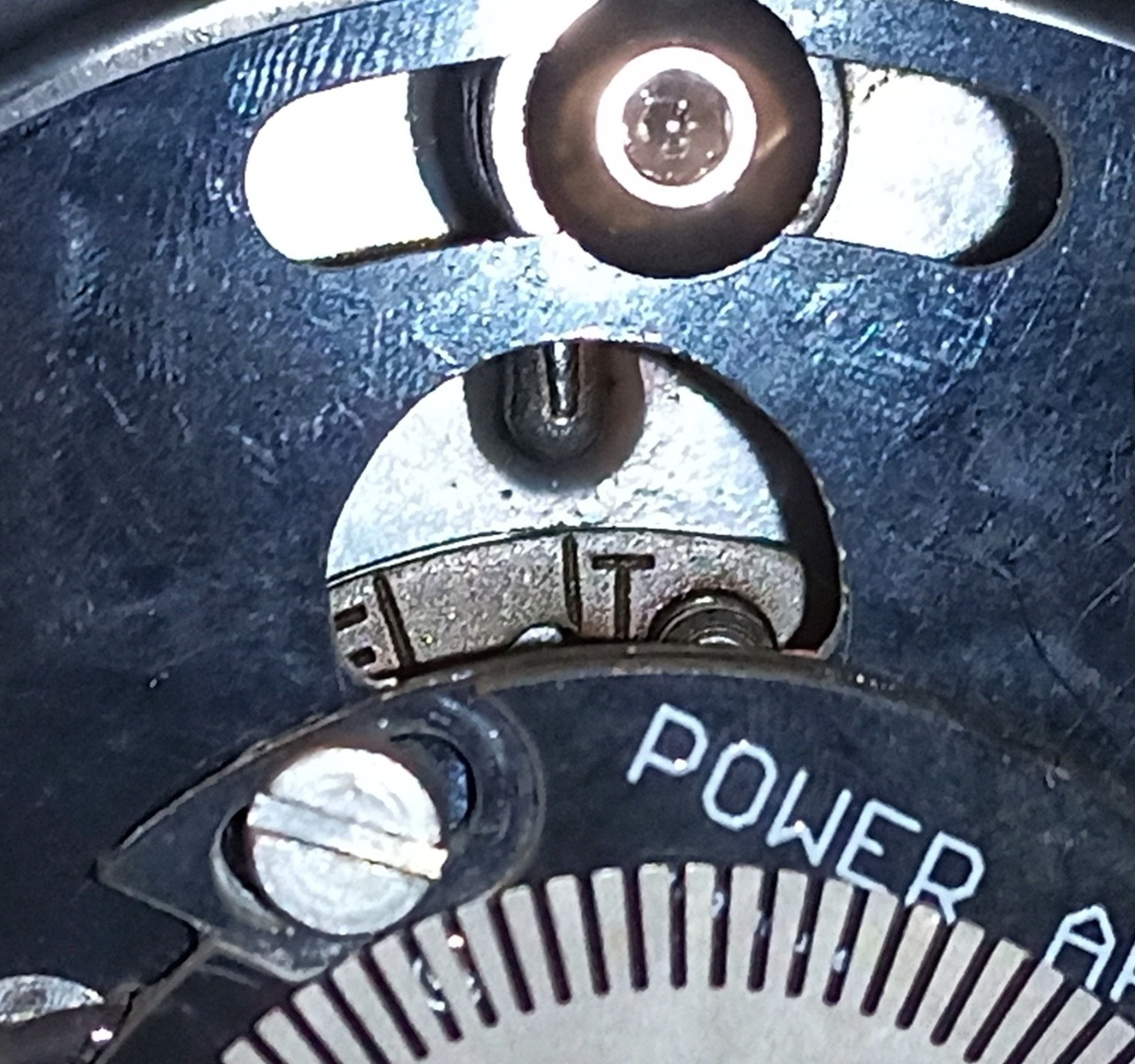

It’s a fairly easy install. I still have my instructions somewhere. If you need them I can go take a look. The main problem is once you remove the factory advancer you loose the ability to turn the engine over with it. You can do it with the kickstarter to turn the engine over for valve adjustments, etc. sometimes you will need to pull the stator cover so you have a way to turn the engine over.
If you’re up for a little extra work I also verify TDC as I personally found the stock timing mark was 2 degrees off.

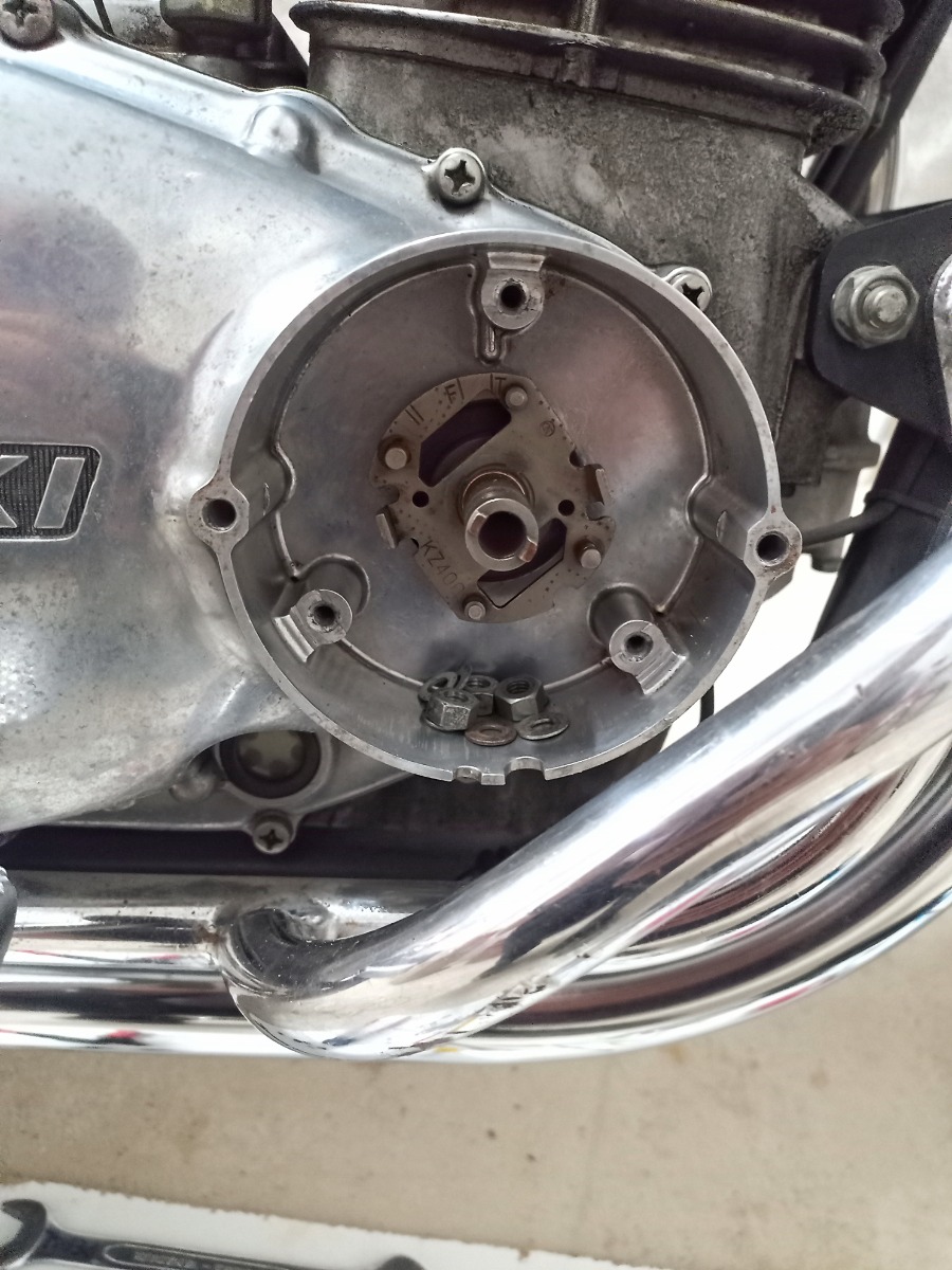

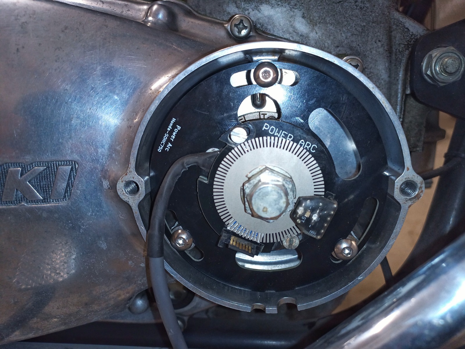

11 Aug 2024 07:17I found a way to preserve the position marks and the ability to rotate the crankshaft:It’s a fairly easy install. I still have my instructions somewhere. If you need them I can go take a look. The main problem is once you remove the factory advancer you loose the ability to turn the engine over with it. You can do it with the kickstarter to turn the engine over for valve adjustments, etc. sometimes you will need to pull the stator cover so you have a way to turn the engine over.
I removed the counterweights and the friction bushing
I placed spacers to adjust the pickup plate to the height of the axis, and fixed the optical disc directly under the 17mm nut
I previously cut out that window so I could see the position of the crankshaft.
I didn't feel like checking the TDC, maybe later. Now I will continue with the assembly, to see if everything finally works well.

I finally finished the assembly.
The bike started the first time, which was a good sign that everything was going well.
When testing it I noticed from the first moment a better throttle response and more power at low RPMs, as if I had obtained some extra HP. At high RPM the final power is probably the same. But clearly this wakes up the KZ400 engine, it feels more lively, less lazy.
The only bad thing I have seen is an increase in detonations during deceleration (I already had them before but now there are more). I loosened the pilot screws 1/2 and I have a feeling it fixed it but I have to test further.
