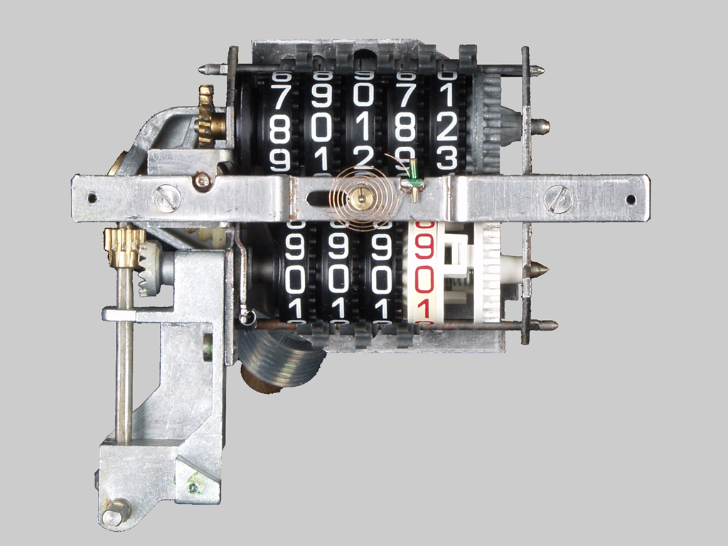

To calibrate your Speedo you have to open the Speedo and adjust the spiral shaped spring attached on the speed indicator shaft. (less preload)
