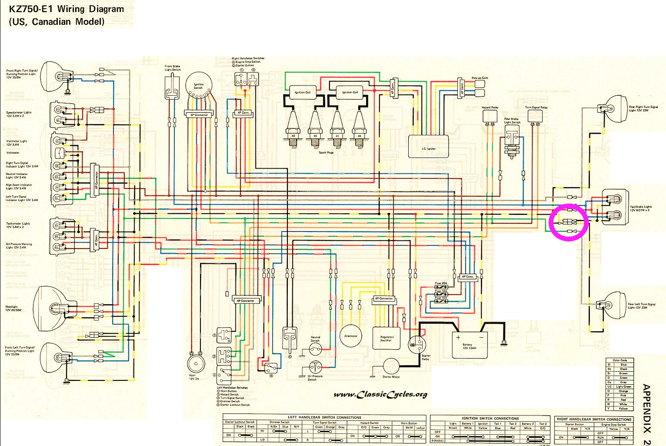

07 Aug 2021 10:24 - 07 Aug 2021 11:57Run a wire from your ground terminal on the battery to the black/yellow connector in the pink circle.
most likely not the issue
schematic courtesy of:
www.classiccycles.org/1852/597943.html

Re: Brake lights
07 Aug 2021 10:37
I’d check the rear wiring harness for pinched or wires with insulation worn off. Somehow you get power from the red wire to the blue. Do the brake lights come on when the ignition is turned on?
