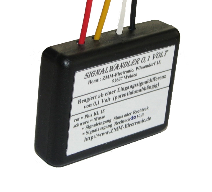

Dyna S ingnitions have a very noisy signal for a modern electronic tach (jumping needle) ! You will need a signal converter to get a clear sinus or square signal out put. I had to do this mod for my KOSO RX2N+
