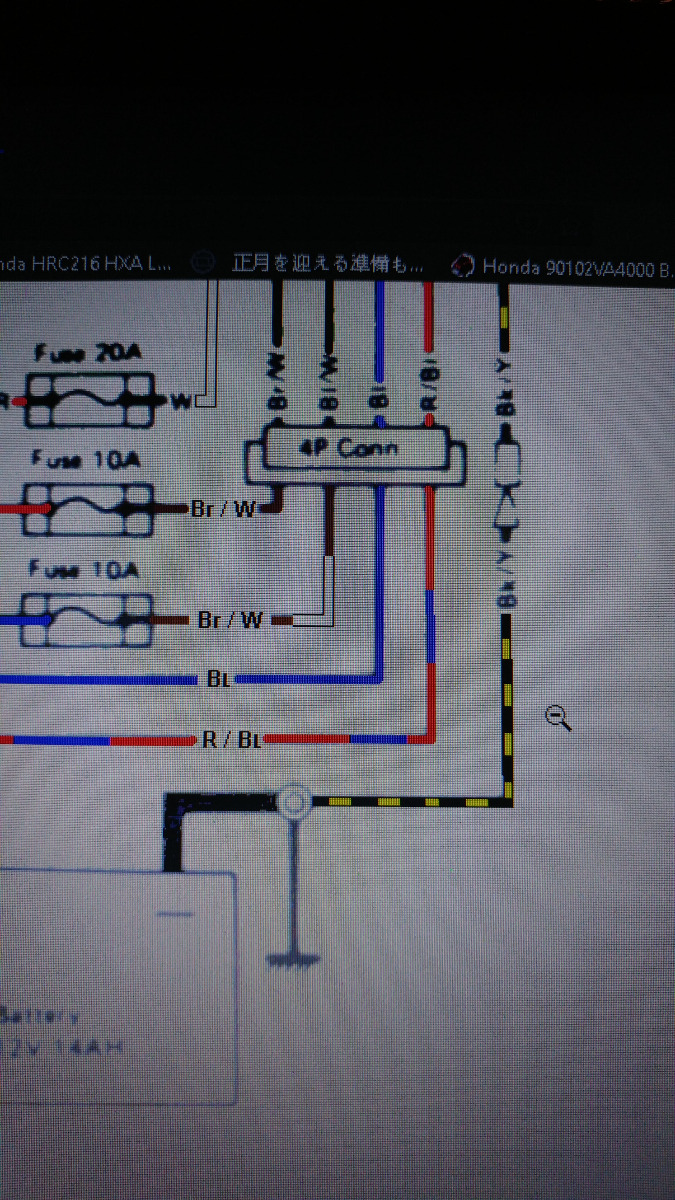

This is gonna be a ton of fun.There is a yellow/black wire that goes to the ground terminal of the battery.Double check you have that connected.
Schematic courtesy of loudhvx
