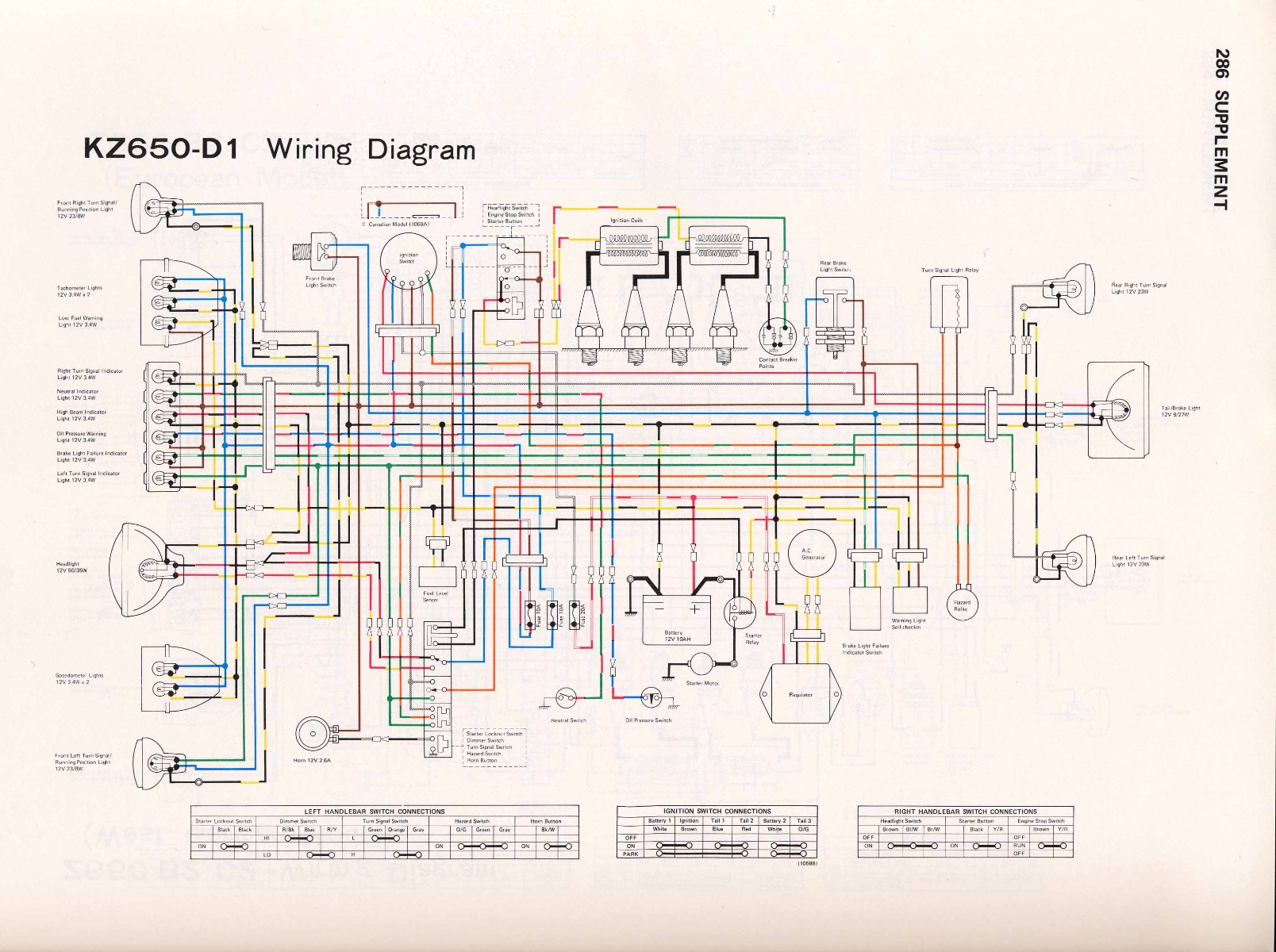

When the ignition switch is set to ON, the tail light should be lighted then get brighter when the brake is applied.
If the tail light doesn't work when the ignition switch is ON, but lights in PARK, then that sounds like a problem at the ignition switch.
maybe a broken solder joint between blue & red inside the switch. ??? see the wiring diagram w continuity table at the bottom.
diagrams.kz650.info/wiring/images/KZ650-D1.jpg

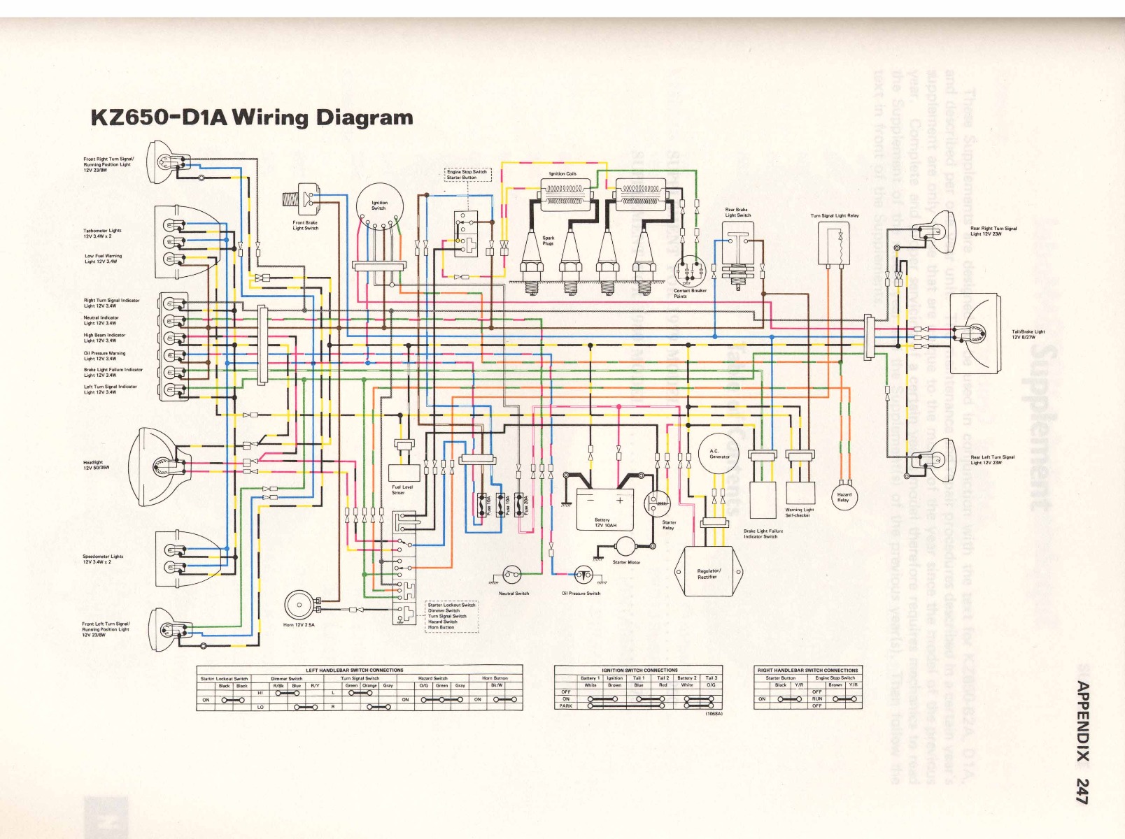

The 1978 650 SR models are either D1or D1A, the only real difference between them is the size of the carbs which came stock on them. Both have front running lights but no rear (other than tail light) running lights. Not sure if you have a wiring diagram for your bike but here are both below. If you want to add rear running lights you would need to replace the rear turn single sockets to dual filament and dual filament bulbs and add wiring to make them work.
