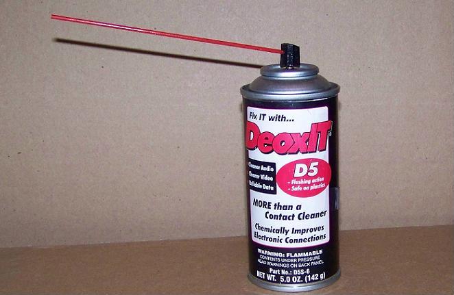

While you are at it, I would recommend putting the WD40 back on the shelf and use a dedicated electrical contact cleaner instead. I think you may be surprised how much better it will work. Deoxit makes a whole line of dedicated cleaners. I like the D5 formula because it leaves behind a very thin film of protectant that will not slow down the flow of electricity.

05 May 2021 05:46Exactly! EdWhile you are at it, I would recommend putting the WD40 back on the shelf and use a dedicated electrical contact cleaner instead. I think you may be surprised how much better it will work. Deoxit makes a whole line of dedicated cleaners. I like the D5 formula because it leaves behind a very thin film of protectant that will not slow down the flow of electricity.

Either I had done something stupid which I will never admit to anyway, or connections were/are bad and decided to work. I think I'll pick up some contact cleaner and electrical grease and hit some connectors.

I would avoid electrical grease. Some of them actually impede the flow of electricity, all of them will leave a mess.
