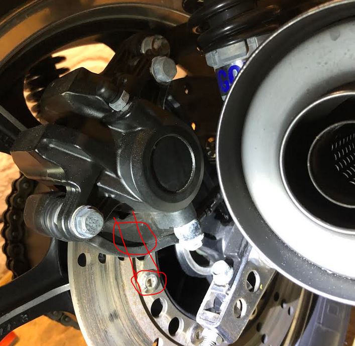

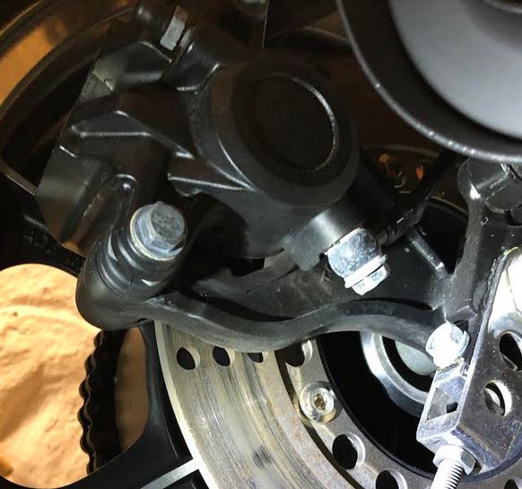

Hi,
I`m looking into install Koso RX2N+ GP Style with sensor on the rear wheel.
There should be straight forward job to drill a whole in the brake calipet bracket and make some threads for a bolt to the sensor bracket?
Shall the sensor pickup the wholes in the brake disc or the bolts holding the brake disc ?
Project:
Project:
Re: Koso RX2N+ GP Style - Switch bracket mounting

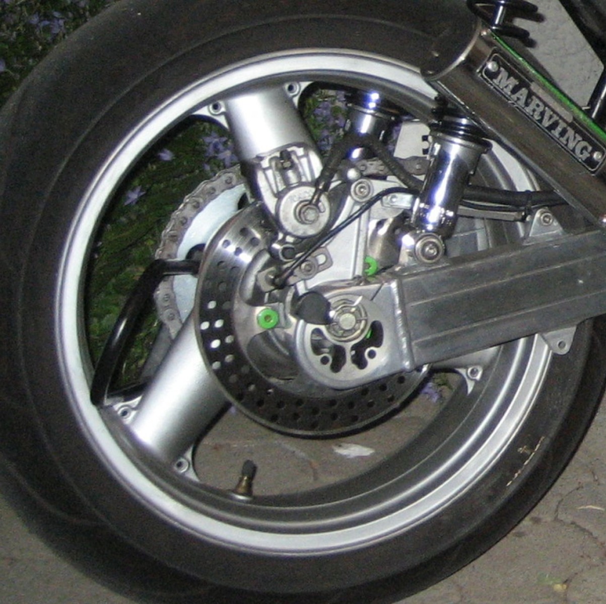

12 Apr 2021 04:37Yes, if your rotor bolts are magnetizable, (some stainless bolts did not), you can use the rotor bolts.Hi,

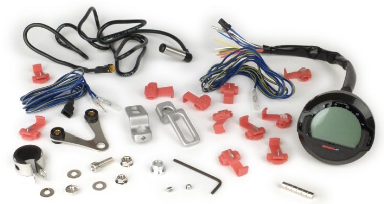

I’m consider a different model from Koso (maybe better match when it comes to style for my bike).
KOSO Digital DL-03SR
I can see it follow magnets for the sensor, does that mean I need to use them?
www.scooter-center.com/en/speedometer-ta...-64mm-black-bb642w20
Project:
Project:
17 Apr 2021 01:44 - 17 Apr 2021 01:45Yes, you need to use the magnets. The KOSO Digital DL-03SR has a passive sensor.I’m consider a different model from Koso (maybe better match when it comes to style for my bike).
