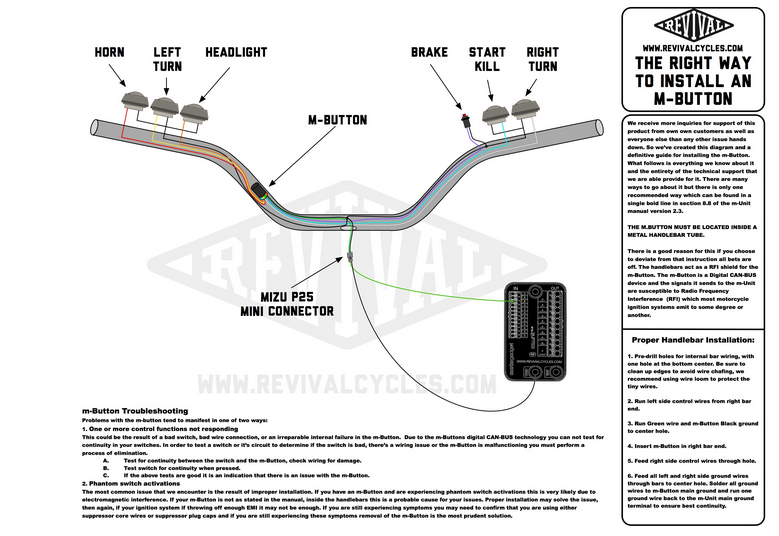

For anyone wondering what a M-button is.
It's tiny module that takes 6 switch inputs on your handlebars and transmits all 6 inputs over 1 wire back to the Motogadget m-unit.
You put the tiny module in the handlebar and connect the short module wires to the switches. Then run 1 wire out of the handlebar instead of
6.
photo-motogadget
photo- revival cycles
6.
photo-motogadget

The M-button uses a low voltage digital signal that is susceptible to electrical interference. You will have to have a resistor in your spark plug cap. Otherwise, it could cause the m button to act weird. You may even run a shielded wire back to the m unit.
The M unit does not like electrical interference.
I had solid core wires with no resistor and my phone couldn't communicate with the m-unit when the bike was running. I put a resistor cap on and phone could talk to the m-unit again.
