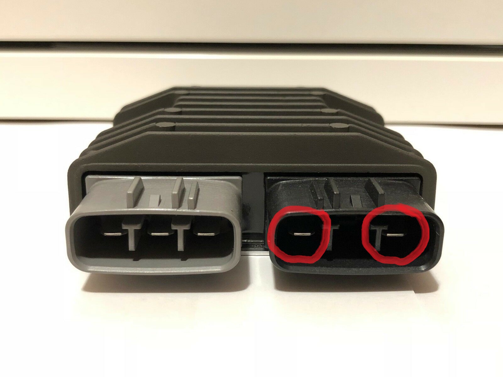

OK. I'm sold. So I just cut off the two adapter harness connectors and splice into where the OEM connector is. 3 yellow to stator, red n black power and ground. What's the leftover sixth wire?

Tape off the sense wire. It's not needed.
Stator wires straight into the R/R. Positive and negative output from the R/R into either the same connectors as the factory R/R or following the same path.

Anyone know which wires go to these 2 terminals? I believe the three yellow wires go to the connector on the left. But what about the remaining 2 terminals?
Thanks.
Thanks.

This is something I put together for the Suzuki GS guys but it pretty much applies for KZ bikes too. Ideally the + output will split with one leg feeding the bike and the other heading over to the battery with a fuse inline.
