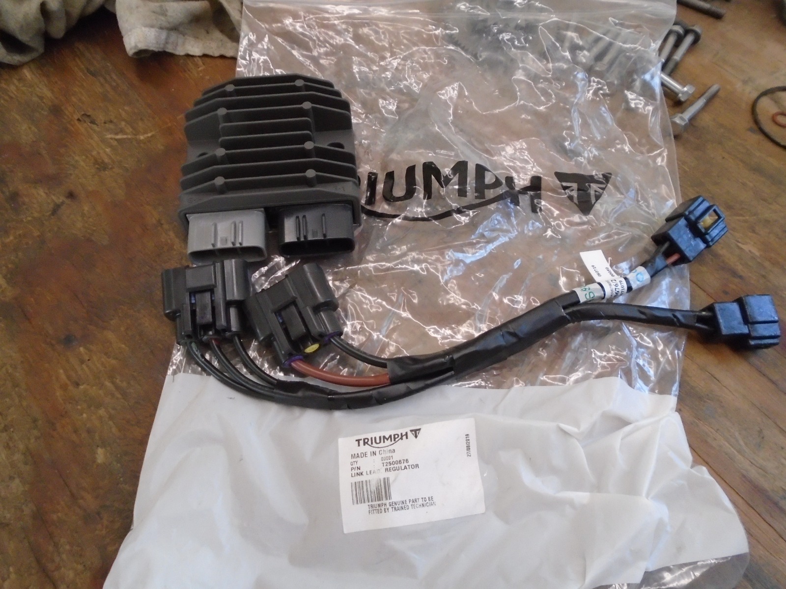

SH775 and a Rick's stator is my preference. Triumph PN T2500676 is a nice adapter harness for the R/R.

Triumph harness though local dealer or online.

And yes, with that Triumph harness the attachment will be waterproof.
