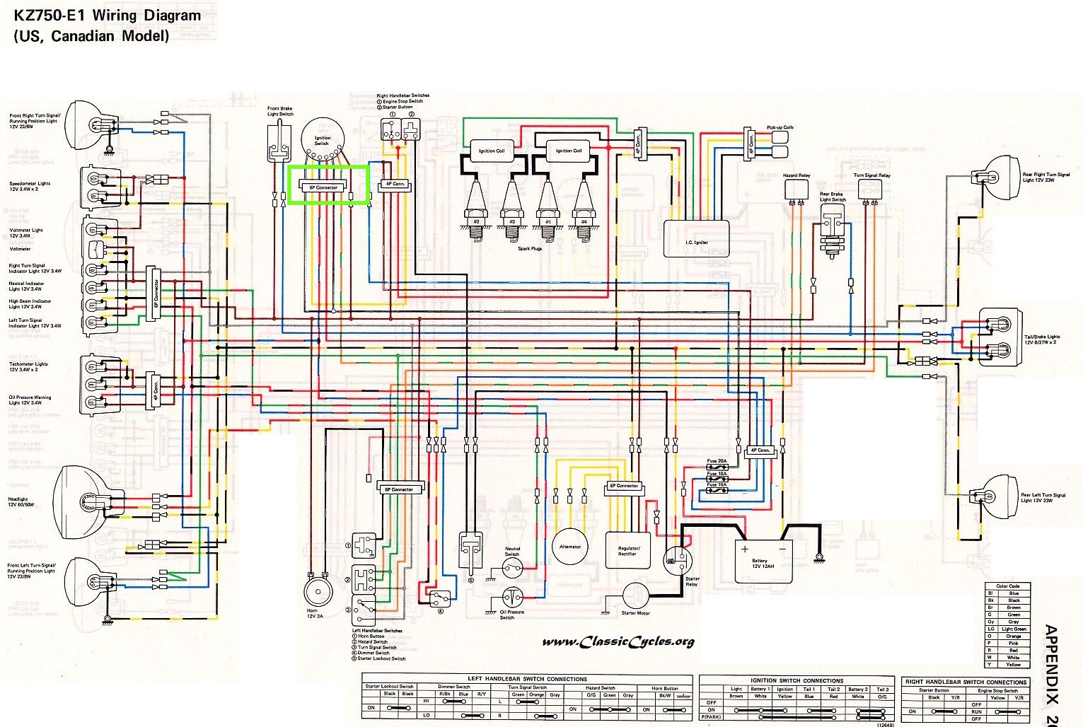

Grab your meter
everything must be connected
meter on DC V
Ignition on/engine off
Black probe on negative battery post( post will be the metal part of the battery)
Red probe on positive battery post
Note voltage
Move Red probe to the white wire in the green box.
Back probe the connector as you don't want to separate the connector.
Probe it on the ignition switch side of the connector.
This will test the white wire from the battery to the red probe.
If you have more than a .5V drop from the first reading (battery) then you have high resistance on that wire.
Then move the Red probe to the other wires in that connector but probe the other side of the connector(the battery side not the ignition side)
Note the readings
Turn off the bike
We'll start here first.

Where is the green box? Thanks for the help.

F64 typically post a wire Schematic with highlighted color coded areas to guide you to the proper wires to test. It appears either it didn’t post of he needs to refill his Ginkgo Biloba :woohoo:
