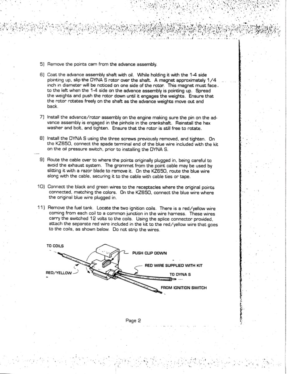

Re: Dyna-S ignition issues.
23 Aug 2020 16:42
Here
Use either advanced mark. It’s just to get close enough to start the bike. Then dynamic time with a light.
