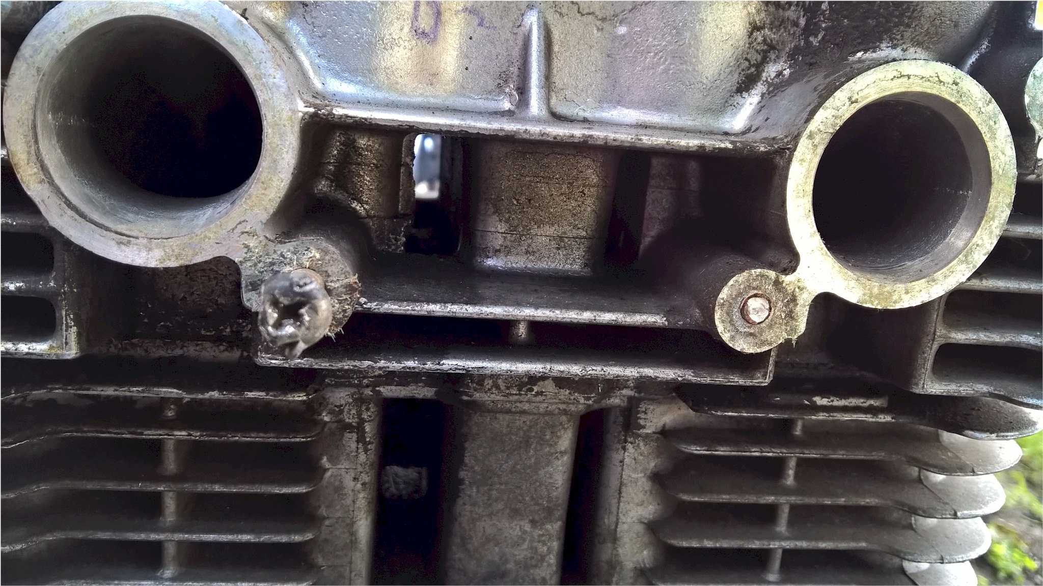

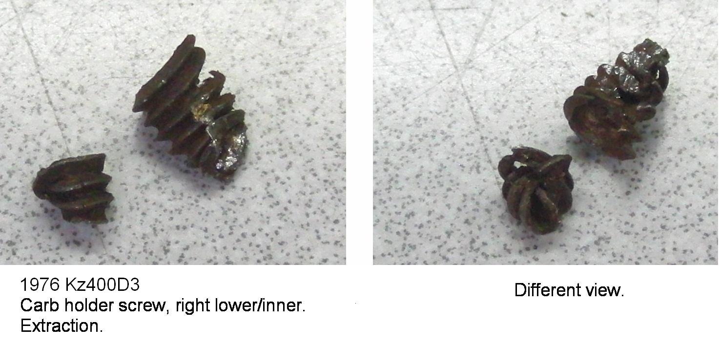

The screws are likely held tight with corrosion rather than over-tightness. Cross-head screws are used to prevent over-tightening which can happen with hex or allen heads.
Have you ever used the chisel method to spin out screws? I've have very good luck with that method. You tap lightly with a small hammer onto a sharp chisel on the head to rock it back and forth slight to shock it loose, while also hitting it in the direction to loosen the head. Eventually it will spin out.
Antiseize the new screws of course.
To get that difficult-to-reach screw head on the starter, you might need to remove the intake rubber. The problem is that the screws holding those are usually the worst for corrosion and often break off. Then you have to use an extractor, which also often breaks off.
I usually end up drilling extremely carefully on those and then extracting the screw in small bits using tiny hooks etc.
The one on the left you can see came out using the chisel method I described. Note how the cuts in the head come from the side, but are angled slightly to spin out the screw. You have to alternate taps 180 degrees apart to cause the head to rock back and forth otherwise you will just chisel the head off.
The one on the right required fully drilling and extracting in bits. It takes hours and patience, but eventually they come out like this.
