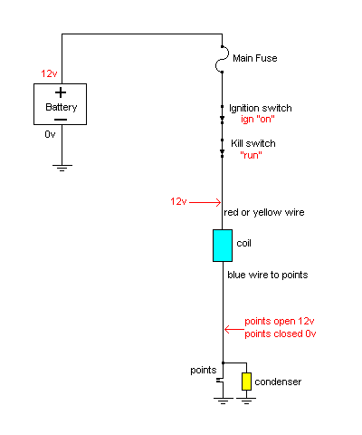

It's normal for the points to spark, and not necessarily be consistent.
How are you checking for spark at the plugs? Do you have both plugs out and laying on the head?
When everything is turned on and ready to run, most of it will have close to battery voltage on it (nominally 12v), but there could be small drops across the fuse and switches.
The wire between the coil and points will either be near 0v if they are closed, or 12v if they are open.
A good place to check is where the coil wire (i think it's blue) attaches to the points.

You really need to focus on the blue wire and the difference when the points are open versus when they are closed.
If the voltage on the blue wire is the same when the points are open versus closed, then something is wired wrong or the points aren't fully moving as necessary.

This reminds me of a screwup I did last year.
The wire going from the points to the coil was always grounded...The washers that isolate the points' terminal hold down screw were in the wrong order....the points' terminal needs to be isolated from ground when the points are open and grounded when the points are closed.
Loudhvx is saying the same thing.
You can use a test light as well. Put the clip on 12V+. Check the tip against a good ground. Then put the tip of the light on the coil terminal coming from the points. Turn the engine over. LIght should turn off everytime the points open.
