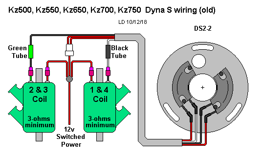

It sucks but I have to just make my own wiring. The jackass that previously owned the bike cut all the connectors to everything and a lot of aftermarket parts that he didn't even have hooked up. But on a plus I did find a simple wiring diagram only question is I have a dyna s ignition and on the diagram it has the stock IC Igniter. Not sure exactly how I rout the wires to it. Any suggestions

The Dyna S replaces the stock igniter & pulsing coil. Z1Enterprises has a link for the installation in the part description. I think you'd use the red power wire that goes to the ignition coils (there's a red wire between the ignition coils & igniter). I guess you'd route the Dyna S wiring pigtail the same as the stock pulsing coil >> the pulsing coil connector is under the battery on my 650-CSR and the other connector with the red power wire is below that one.
