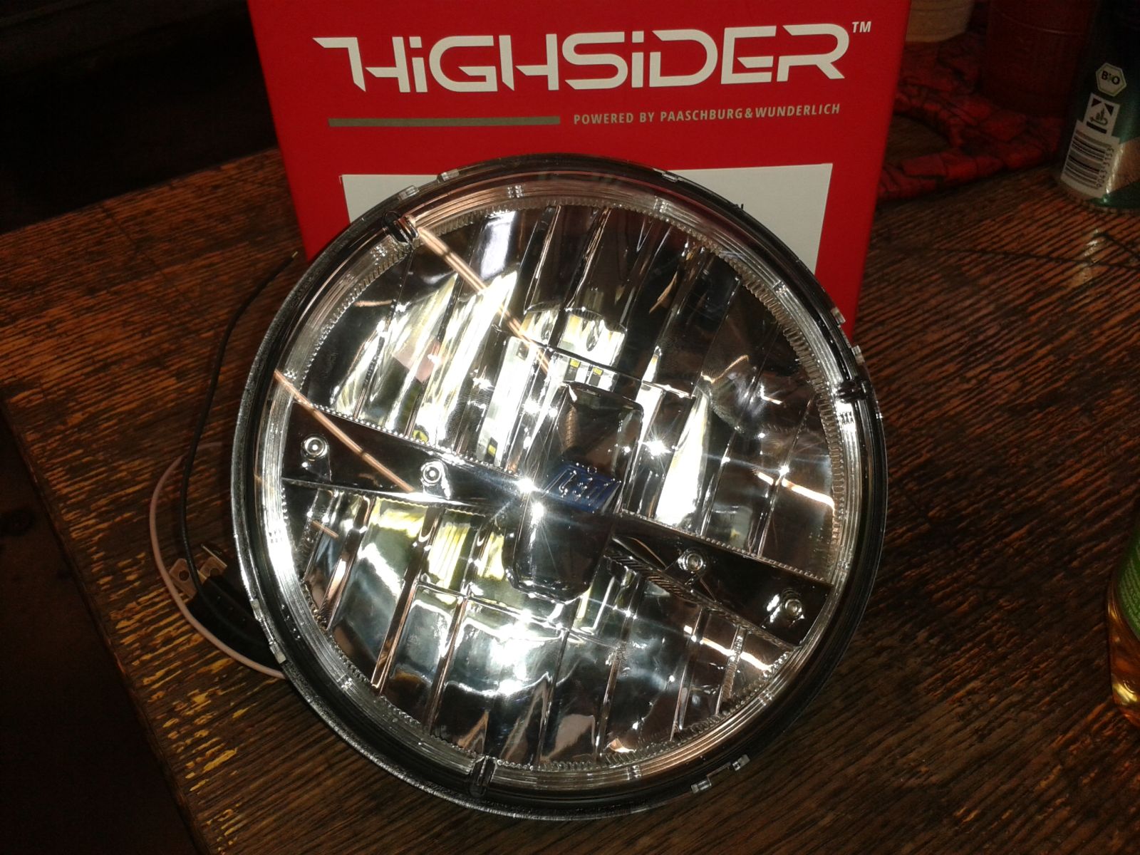

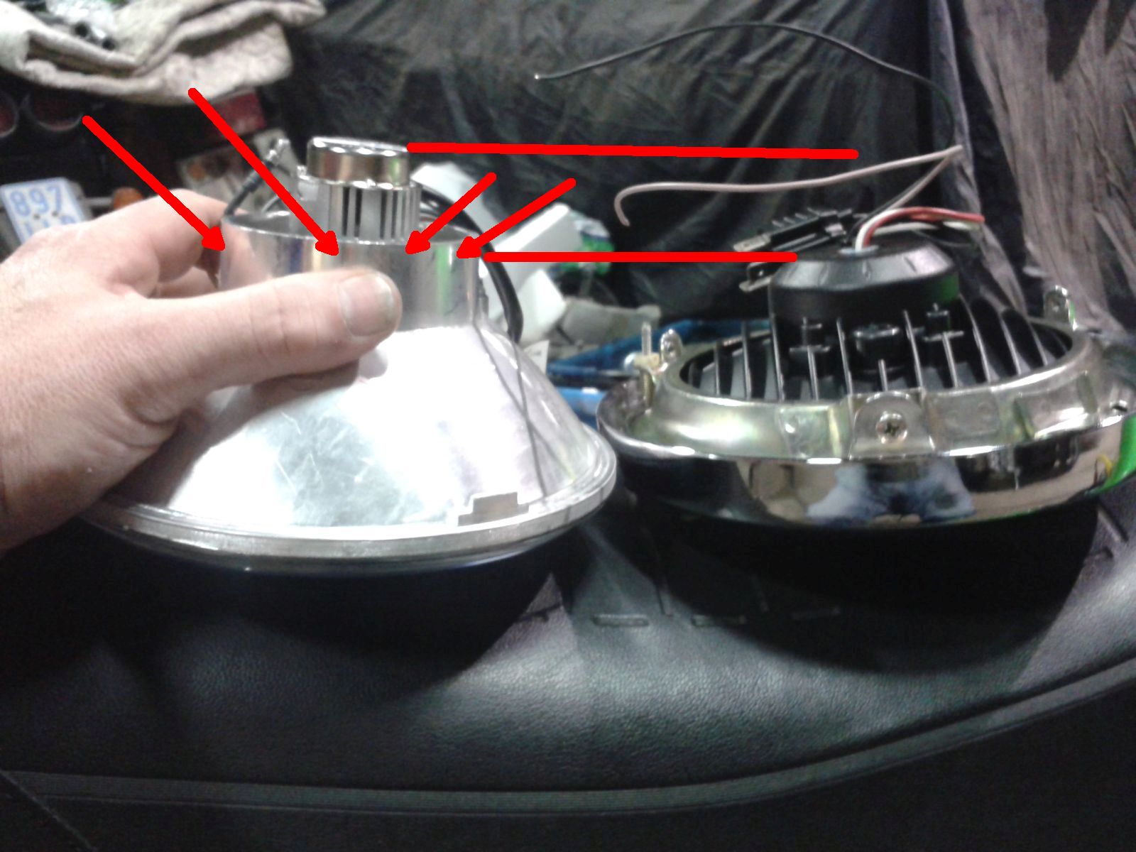

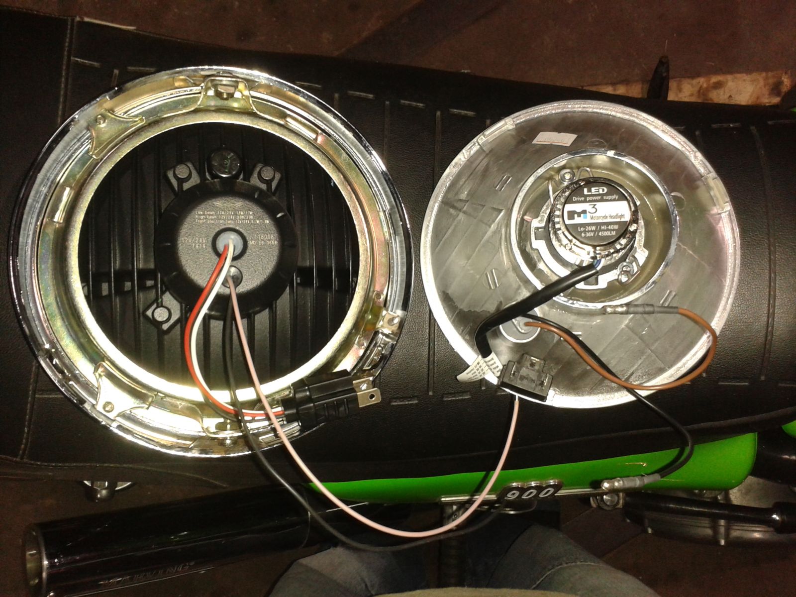

I have replace my head light with an Highsider Type 3 LED main head light insert. It´s plug and play, no mods needed to fit into the Z1 head light frame.
The following user(s) said Thank You: Flatblackobsession
