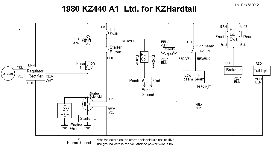

Has someone made an simplified/barebone wiring diagram for a kz440? Previous owner has made an mess with the wiring and it would be very time consuming for me to sort it out... If someone has what im looking for please share :laugh: :laugh:

There are schematics on the forum. Try searching. I'm too lazy to do it for you but I do remember it being posted several times in the past.

So I found these three, hope that the colors match my year model.
www.kzrider.com/forum/attachment/44687
www.kzrider.com/forum/attachment/124138
www.kzrider.com/forum/attachment/87677

Kawasaki wire colors are fairly standardized, but you could use the stock wiring diagram for comparison to double-check everything.
The KZ400.com site has a factory service manual & wiring diagrams for the 440. The wiring diagrams are in the technical tips section.
Forum warning: from what others have reported the forums on the KZ400.com site might harm your computer.
1980-82 KZ440 manual w supplements
