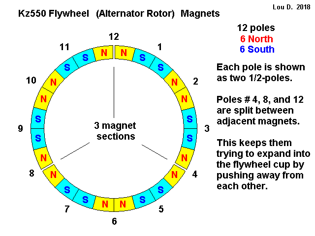

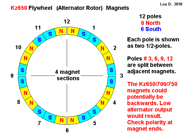

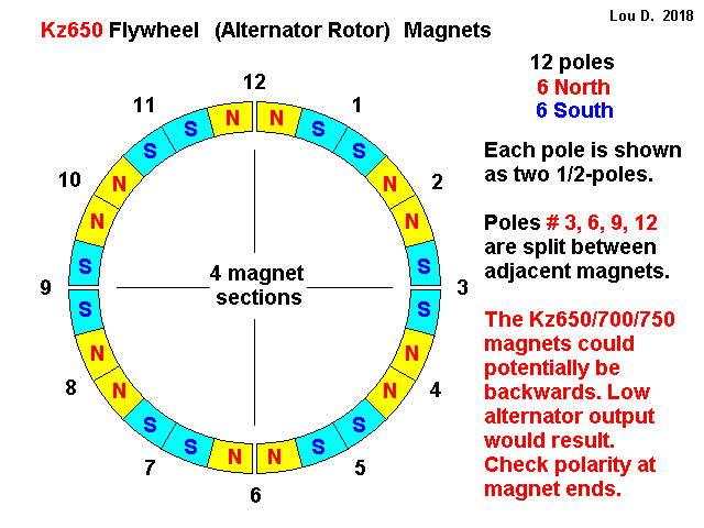

This problem has come up so many times I have created a graphic and a video to address one possible reason why only some 78/79 Kz650's have this problem. It's not all of them either. It is just some percentage of those models. Some 78/79 Kz650's have no problem with a Dyna S and stock charging system, but when the problem comes up, 90% of the time it's a 78 or 79 650.
I have speculated that some 78 /79 Kz650 had one of the flywheel magnets flipped at the factory, but I haven't been able to look into it any further to rule it out. The factory originally used a design that could potentially end up with one magnet reversed. Then they changed the design to a type where the magnet would work the same no matter how it was installed.

Any idea if the kz550 magneto will fit the kz650? Im willing to buy one to test your hypothesis
