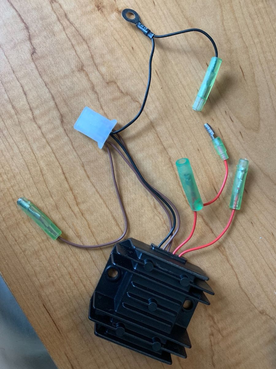

The new combo regulator/rectifier has five wires coming out of it. Two brown and one black wire come out and create a 3-pin connector which is where I’m guessing the three yellow stator wires should go. But the black wire also jumps back out of the back side of this connector and gives you a eye hole connector and then terminates in a round push connector. One of the brown wires also jumps out and ends in a round push connector. The other two wires coming out are red with one ending in a single round push connector and the other ending in two with one being male and the other female.

One is the B1 wiring diagram. One is the original regulator still in place. One is the new combo regulator/rectifier. And the last is the currently gaping hole where the battery would normally be, but you can make out all of the existing loose wires I have.

It doesn't have three yellow wires coming out of it. The regulator looks like a single phase unit. What does the original rectifier look like? Are those three yellow wires coming from the stator? You may not be able to use that R/R at all.

More complicated than it needs to be. Looks like the green wire is ground. Doing away with the black and white split I would combine them. One feeds the starter solenoid and lighting circuit and the other goes to the fuse box but still cant see how the one from Z1E would work. With a SH 775 it would be better and easier. Three yellow in, black to green (ground) and red to battery.
