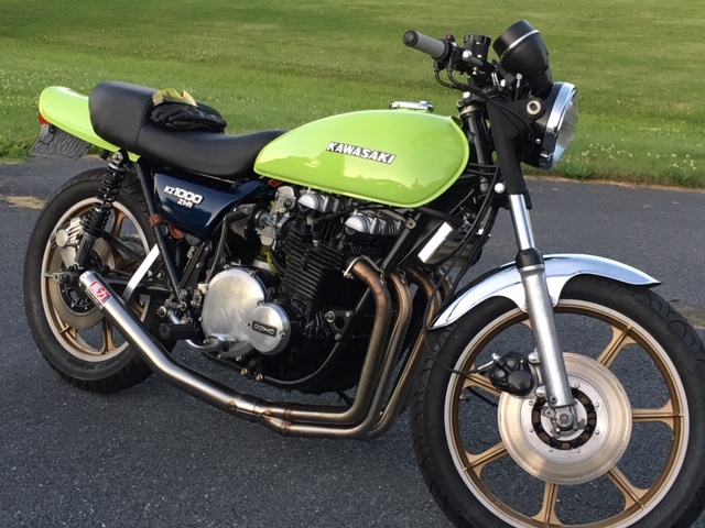

SO I just posted a question and I don't think it was successful, if it was I'm sorry the powers that be. Anyway. Been breaking in a new build. Got 100 miles on it as of Sunday and Monday night did another oil change and I added a 1/4 turn to the manual cam chain adjuster. Today - Tuesday - I woke up and rode for about 20 minutes. Stopped, got gas and then as a I started to ride home the bike got funny. Lost power, was hesitant and the exhaust was muffled. whole thing sounded anemic or just not 100% there. I've certainly had this issue before and I cannot recall how I fixed it. Pretty sure it has to do with the coil wires - mostly electric at least that was a previous and usually ongoing issue. The bike is mostly all brand new. Battery is good, charging system is good, no blown fuses, full power to gauges. Bike wants to start. Carbs are excellent - clean and rebuilt. Two days ago the bike was a screamer. Something got pinched or burnt or cut. Any ideas? I am at work at the moment - cant stop thinking about the problem. So when I get home ill pull the tank and check the coils/ wiring. I am sure ill figure it out but now that the bike is running and no longer a full time project I figured it would be good to get back onto the forums. Thanks ahead of time. You guys and girls are great.
