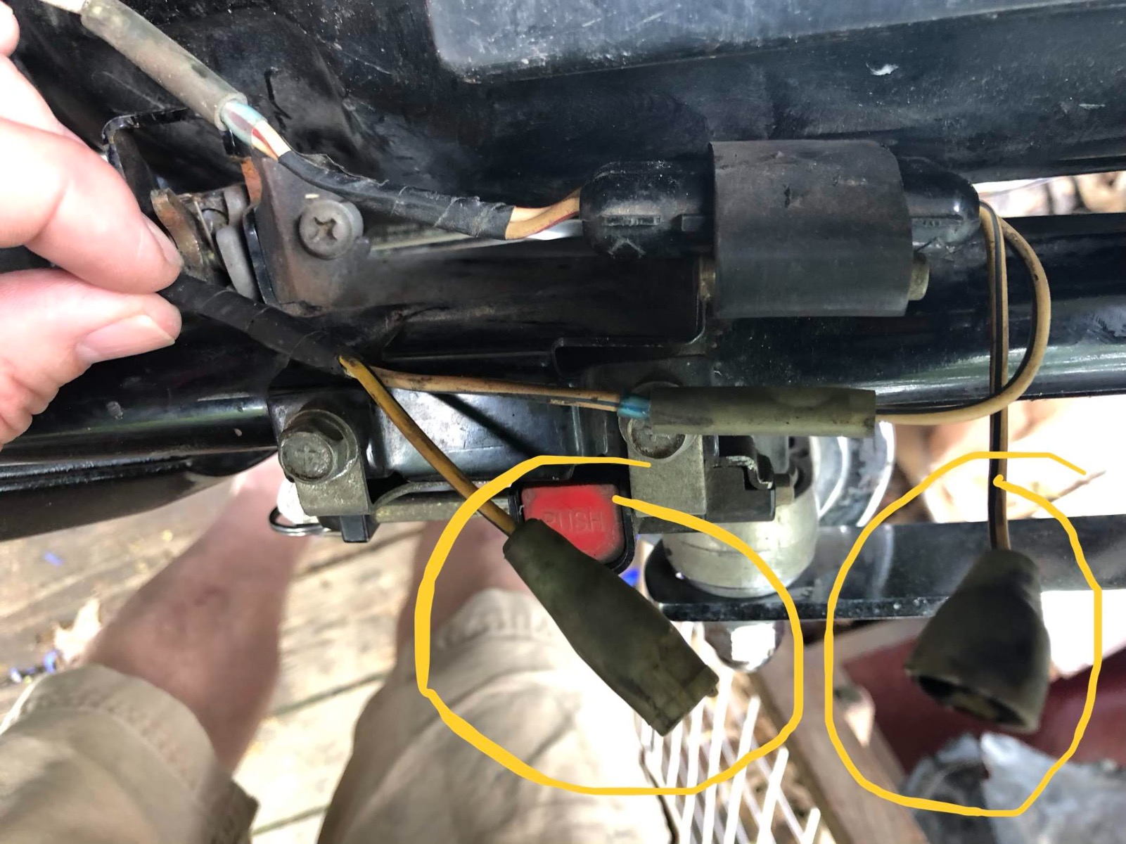

Hi there,
I'm trying to figure out where this wire coming off the inline fuse goes to, or if it goes to anything. There is another wire that has nothing connected to it as well. Do they go together? Both are circled in yellow.
Thanks
Thanks

The accessory fuse box is in the pic, so the terminal on the right is an accessory wire lead. Notice that the acc fuse box has another wire lead & it may terminate inside the headlight bucket.
The other terminal may be an accessory ground. Black-yellow is usually ground, but I would check it with a multimeter to verify. There may be an acc ground terminal at the headlight bucket as well.

This is a good point but I'm not sure what my letter designation is. My signature says 1983 Kawasaki KZ 750 LTD. Do I find the letter designation under the seat? On the rear fender? I am new to this bike. I noticed in the Clymer manual, there is no wiring diagram for the twins. I thought that was odd.

Ok, the tag says JKAKZDK1 so this is a K1.
The black/yellow wire coming from the inline fuse box shows 12v without the ignition on. The other wire is a ground.

20 May 2019 05:10 - 20 May 2019 05:53sharkmonkey wrote: Ok, the tag says JKAKZDK1 so this is a K1.
Would re-examine the wiring diagram, as I'm reasonably certain that the black/yellow wire is supposed to be a ground.

20 May 2019 06:15 - 20 May 2019 06:16
The wire is probably discolored. Sometimes it's difficult to determine what color an old wire is.
As Patton suggested, look more carefully & try cleaning it with silicone spray or Endust or something.

Patton, that wiring diagram link is to an older B model bike. I'm not sure if you can edit the label on the diagram in the filebase as that is a 78 Kz750B3 model diagram. Hopefully you can.
The newer K model may use yellow/black stripe for something other than ground. I do see that color combination used for grounds occasionally, but I'm not sure it's a rule. (Whereas black/yellow stripe is pretty much a rule that it is ground.)

Black/Yellow or Yellow/Black for battery negativ, frame and engine negative terminal?
Other then Honda (Green), Kawasaki has a black main colour wire with an small/thin yellow strip for the negative terminal. A main yellow colour with an small/thin black strip wire is not a negativ terminal.
