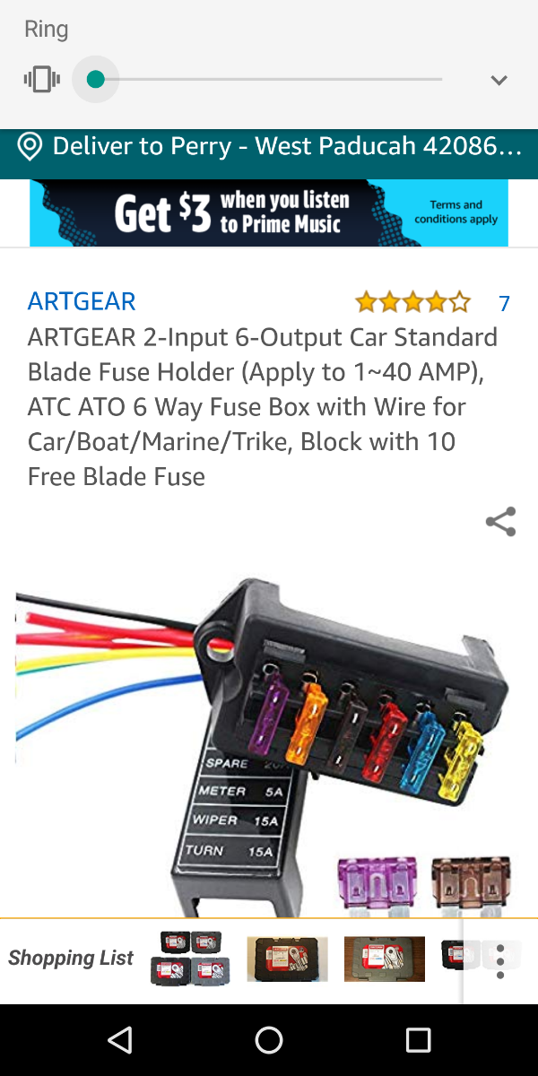

I got tired of glass tube fuses, always being corroded and losing tension. Replaced with ATC fuse 6 place have Xtra slots for Xtra fuses. ( ;> Very similar to the one pictured below . ( I do keep and have all the original parts to put her back to stock/original )
